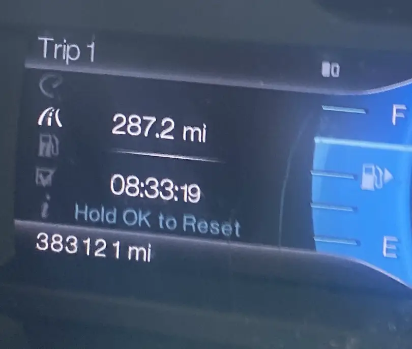

On a side note 380,000 miles is awesome!

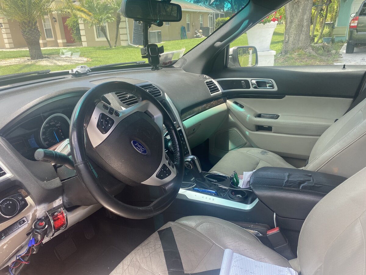

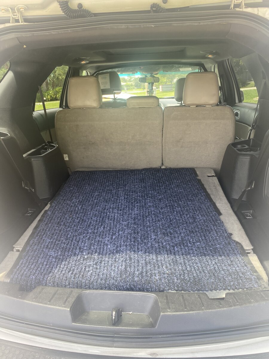

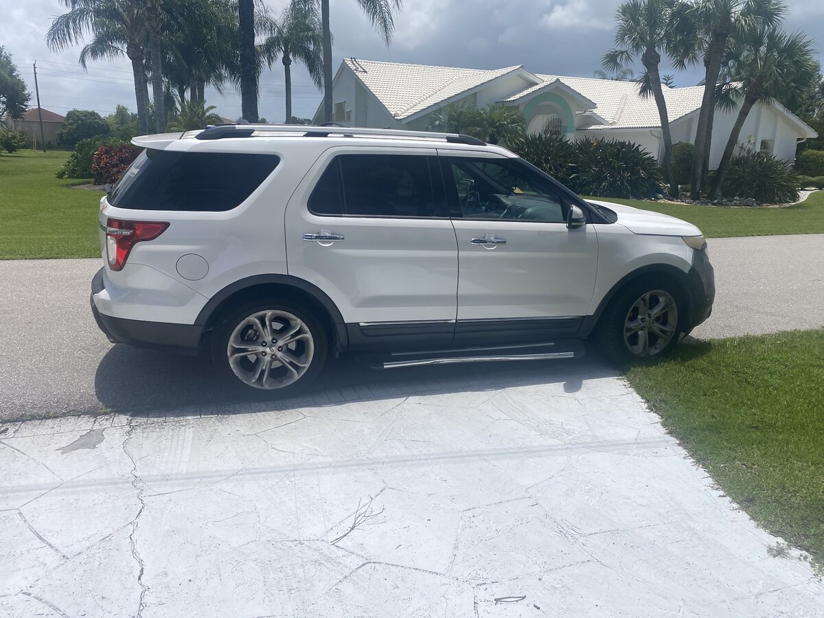

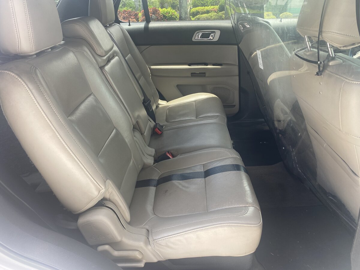

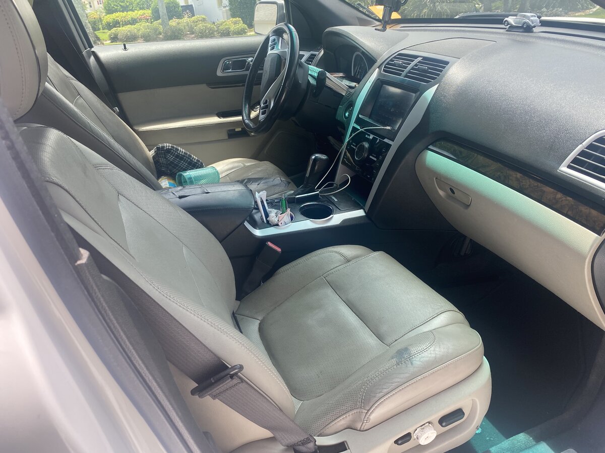

Can you post some pictures of it?
As requested some pics of my 2011 limited
Looks like sex on wheels. The body looks in extremely good condition for the mileage.
looks really nice, i can tell youve taken care of it!!!! for >300k, looks sharp! looks better than most of the 5gs i see on the road here!
