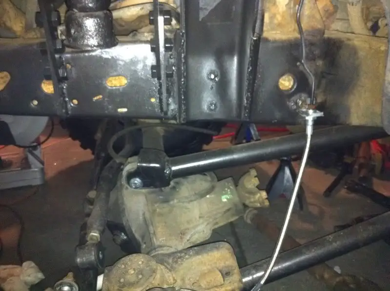

I'll be picking up my D30 from a TJ with 4.10s (to match the 4.10 i already have) plus, its 50% day at the JY :D i will be making my own custom three link, using ballistic joints on the frame side & Rustys superflex joints at the axle, lower links are 1.5" DOM .120 wall sleeved with 2" DOM .250 Wall. Third link is 1.5" DOM .120 wall with a Creeper joint at the frame and stock jk end on the axle.
Ill also be using an adjustable track bar from an XJ that im getting for free, the coil buckets are from ballistic and the shock towers are f250 ones. The steering box will be from an ifs Toyota with a trailgear pitman arm, the return line is stock while the stock pressure line was lengthened, ill also be using a hybrid shaft from the toy box and stock explorer shafts. all the steering on the axle will be chevy TRE over the knuckle with 1.25" .250 tubing and the drag link is the same tube with 3/4 heims. Brake lines will be from Rustys, going to use Wild Horse EB 5.5" springs and shocks are Bilstein 5125 12" travel and im going to SOA the rear with the stock shocks mounted in the top sway bar hole.

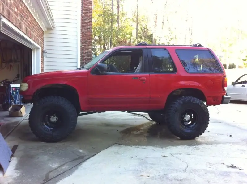

I moved the axle 3" forward for a wheel base of 105" and will be using a hybrid driveshaft from a first gen and my 95-96 front shaft. Now has 35/1250/15 new MTR's on 15x10 black wheels (don't know what kind) and kept the spacers up front.

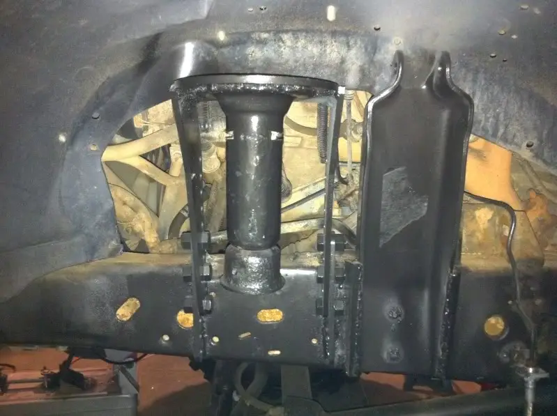

Wondering why you modified the crossmember? It shouldn't have caused any problems as it was.
TarHeel085
And den
August 22, 2001
4,103
4
Raleigh, NC
'99 Sport 4wd
Looking good.
My mount for the upper link sits exactly where the stock crossmember bracket sat. Plus mine must be different then newer truck because the front driveshaft was bottoming out a lot sooner then it should be.

Looks beefy. My welds weren't the prettiest on those brackets either, but after cutting them off tonight and seeing the penetration, there was no need for worry!

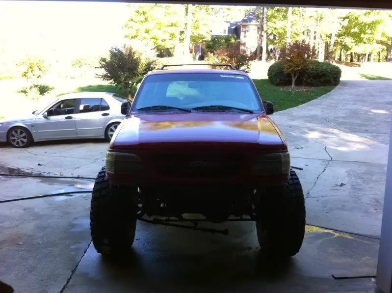

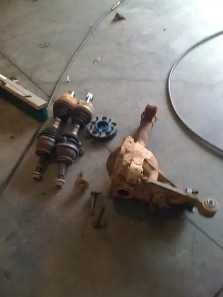

not that there is much interest in this build, but im documenting non the less. front axle is out.
the arms i got are 2" OD, .370 wall with large Rubicon Express joints on each end. the coils are rubicon express 5.5 TJ coils

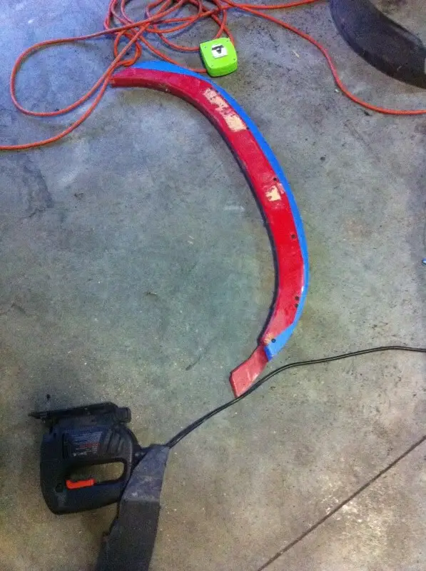

I Dig It!!! Any plans for the cleaning up the fender cuts/holes in rear fender? Were you able to sell the grey tupperware?

Okay what did you do about steering?
TarHeel085
And den
August 22, 2001
4,103
4
Raleigh, NC
'99 Sport 4wd
had to switch my plan on the steering. going with a toy box outside the frame. also going with WJ high-steer knuckles and bigger brakes using the JKS knuckle spacer. ill be using heims and tube as my drag link
