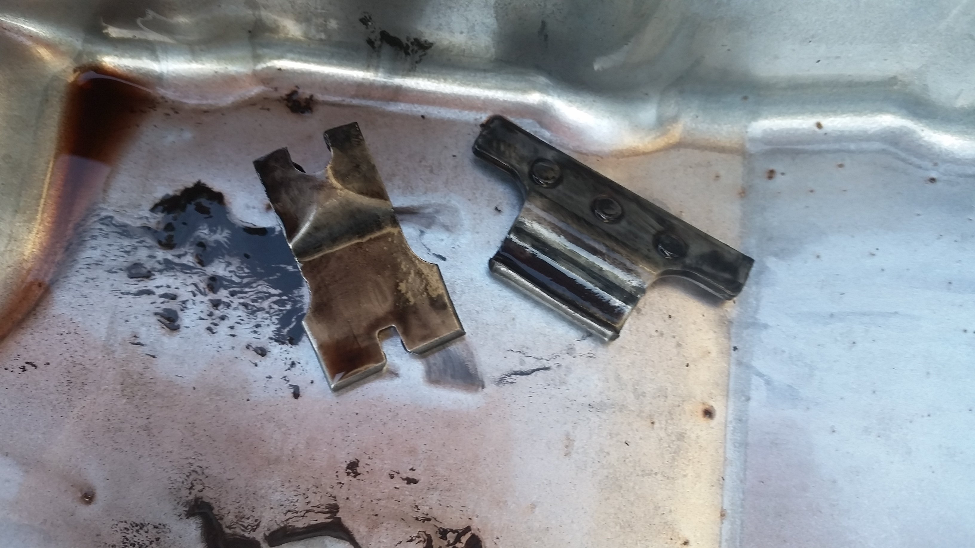

I was getting a P0745 ODB error -Pressure control solenoid -Transmission. I thought I'd remove the pan replace the fluid and filter. I found these two parts laying in the pan. Anyone know what they are and what I should do? It's a 4.0L 2002 explorer with the towing transmission.
Well, that don't look good. I don't know but someone will come along shortly and recognize those parts. I'm guessing it has something to do with one of the bands?
