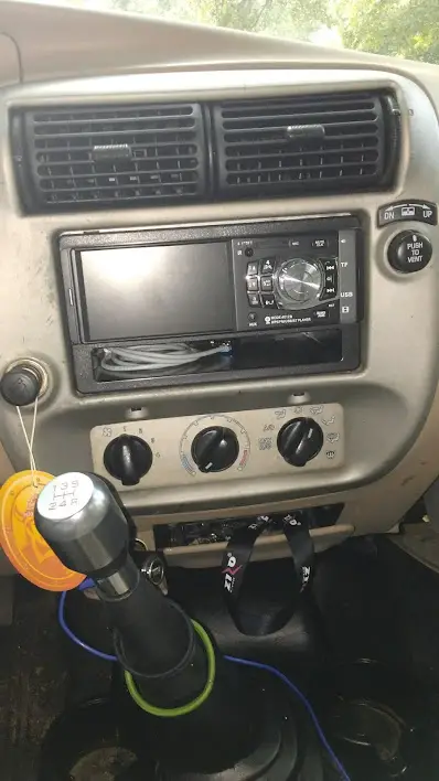

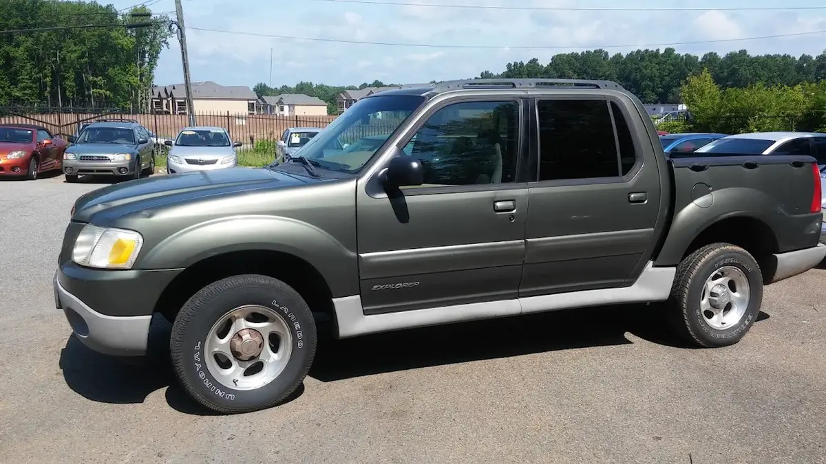

Bought one...2002 with 5 speed manual and 148k miles. It only took 6 months to find one I could afford. This will replace my 98 sport with 5 speed that was approaching 300k miles.
Then I changed shifter knob for a smaller one that fits my hand more comfortably.
I used a little bit of electrical tape to cover the splines. Seems to be holding well enough so I've abandoned plans to JBWeld it on.
This weekend I have to trouble shoot why the mirrors and back window don't work.
Last week, I switched the mirror switch from my Sport into the ST, got full function on drivers side, only up down on passenger side. Then I put the radio from the Sport into the ST and the factory radio on the seat of the Sport for later install.
