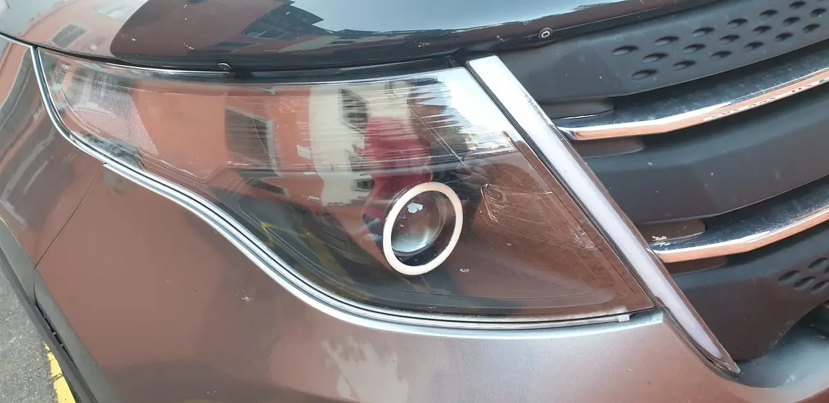

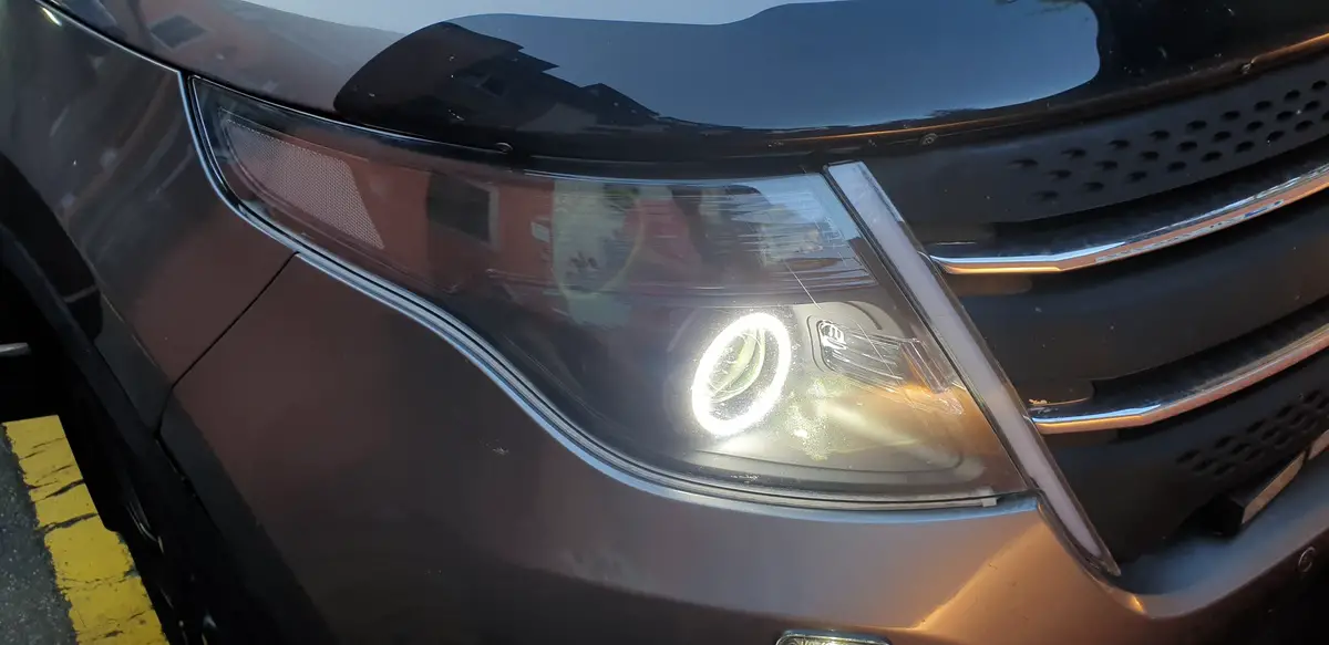

To follow up from where I left off, here's my last post where I had a finished self-designed 3D printed headlight bracket:
What did you do to your 5th Gen today? and
this one.
Since I don't expect anyone to keep track of what my planned project was, I'll sum up. I essentially installed the following into a set of Ebay purchased "clear" headlight units for the 11-15 Explorer.

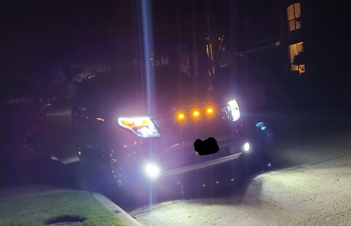

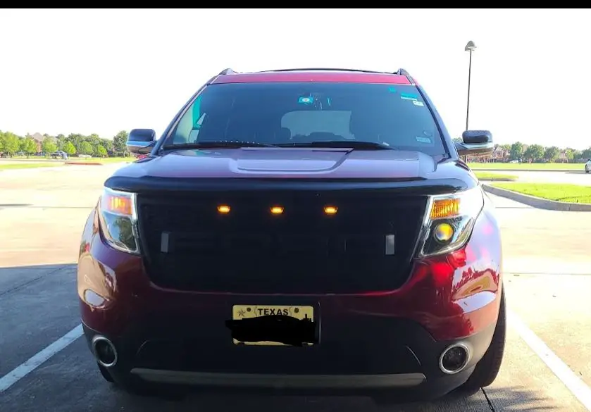

Ok, to the results. Pardon the dirty headlights, it looks like there's dirt inside, but it's all outside. (Ignore The vertical LED on the right, that's not part of this project and is just a
purchased DRL)
Everything off:
Halo (DRL) and headlight on:
Lights on, and turning:
Me pushing the "unlock" button:
