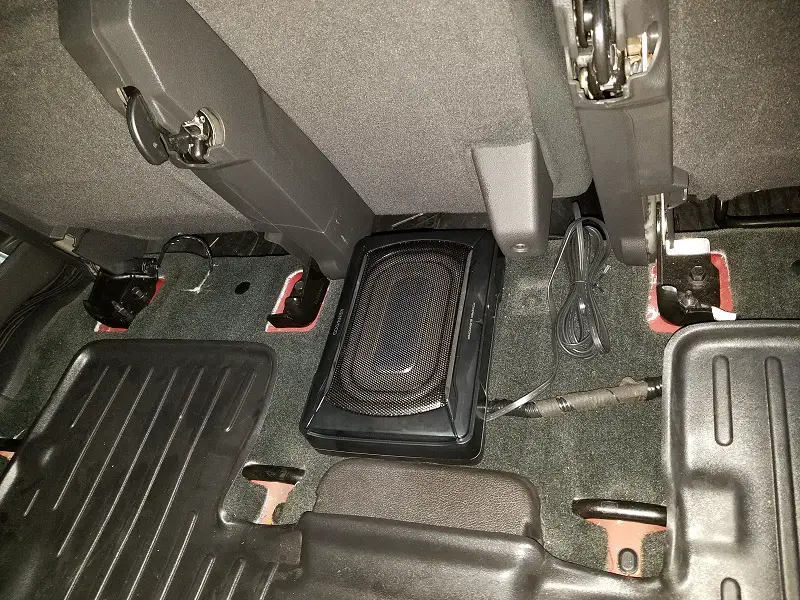

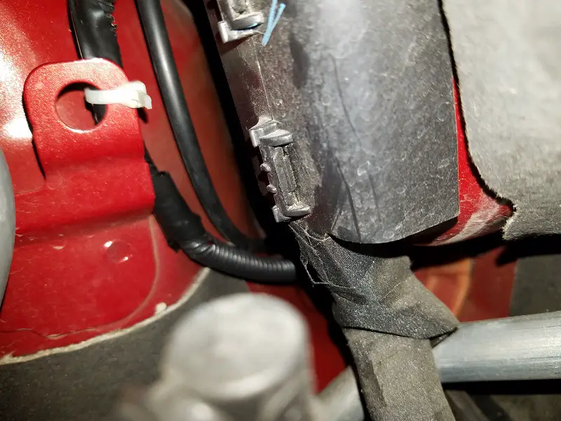

Installed a powered sub woofer Kenwood KSC SW11, I placed it under the middle seat of the 2nd row seat, it fits just enough, I was able route a 10 gauge wire on the grommet being used for the rear windshield washer line behind the glove box, it's a pain to get to but no drilling needed. before that I also replaced the 4 speakers front and rear with JBLs 6x9 (3way) and 5.25 (2 way). It now sounds a real premium sounds.
Where did you put your sub? How hard was it to run all the wiring to the stereo? Or did you use the speaker for audio.
