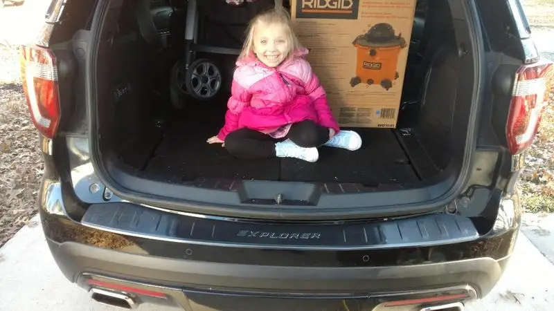

This wasn't today but was recent so I will share. My 4 year old put on a black stainless bumper cover

Can’t see the picture
Strange because I can see it even with you using the quote the picture is in that.
I just copied and pasted the picture so I am assuming that to be the issue, but I dont see an option to browse files to insert an image from my computer. Any help would be appreciated.

Ok lets try this again, let me know if it works. I recently added a rear black stainless bumper protector (so easy my 4 year old could do it). Also, swapped out the blue Ford emblems for black ones. Again with the help of my 4 year old. It was rather simple to swap out and there have been several discussions on the "how to". All you need is a deep well 10 mm socket and ratchet along with a flat head screwdriver. Remove the bolts from the shroud over the grill, pop the two pins holding the shroud in place, pull a little on the grill to get your hand behind and loosen the two nuts on the emblem and it will then pop right off. I have seen where a lot of people cut behind, but this was so easy I would not recommend anyone go the route of cutting and risk damaging anything. Start to finish took about 45 minutes to do front and rear including getting my tools out and finding what I needed and cleaning everything up after the project was completed.

Looks good. Future 'Car Gal'? :D

I sure hope so haha! We have some mudflaps coming in today that I am sure she will want to help put on when I get around to it. Also been toying with the idea of having the exhaust tip surrounds powder coated black so she could help me get those off too. Figure if I get her excited about it young it might stick with her as she grows up.

Where did you get the black stainless bumper cover?

Got it off eBay from China. Was an absolute fiasco getting it here though. Sat at ISC up in Chicago after clearing customs for ever and I opened a case to locate and everything then finally USPS shipped it back to China. The seller notified me and reshipped thankfully. Took almost three months to finally get it in : (

The only concern I would have with it is the possibility dents and ice buildup.
