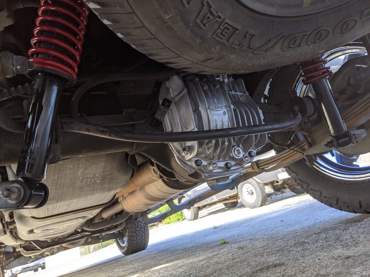

Installed GT500 cover and changed fluid. First change @ 50k, now 105k. No shimmering or shiney stuff, and added bonus-- not much smell! There is a fin on inside of cover that needs grinding off for clearance of ABS toner ring. Noticed leaky driver side shock Gabriel overload time.

How do you like the ride/handling?
BIG improvement, driver side stocker was leaking, and was dead so anything would have been better.
Rear feels so much more stable. Right off the bat they made it obvious the fronts had to go, and received Bilsteins yesterday.
Plan to install today.
Nice, where do you get the bilstein shocks from?
