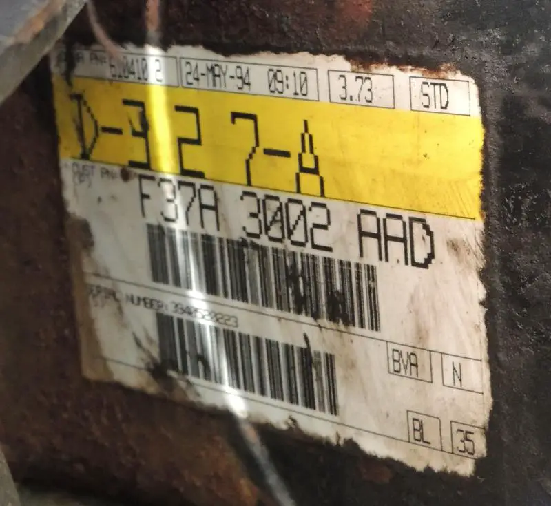

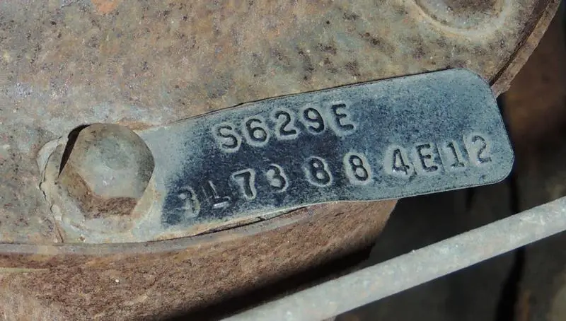

Front Axle
Rear Axle
First time adding pics. My axle ID's. 3.73 limited.
When I went to a 31" tire I noticed a bit of a power loss but nothing significant. It would shift out of OD more often on the highway etc. I have 3.73 as well.

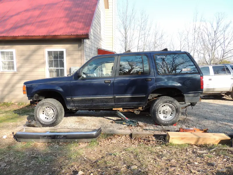

Finished installing body lift today. Had to cut one of the rear bushings off. Where can I find body mount hardware. The nut and washer assembly that goes through the bushing. And does anyone know what the body mount bolt torque specs are?

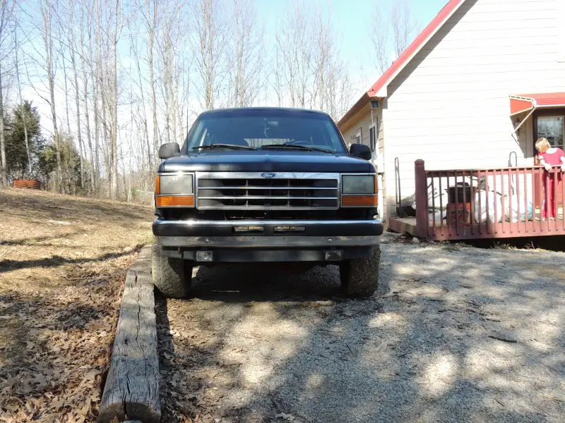

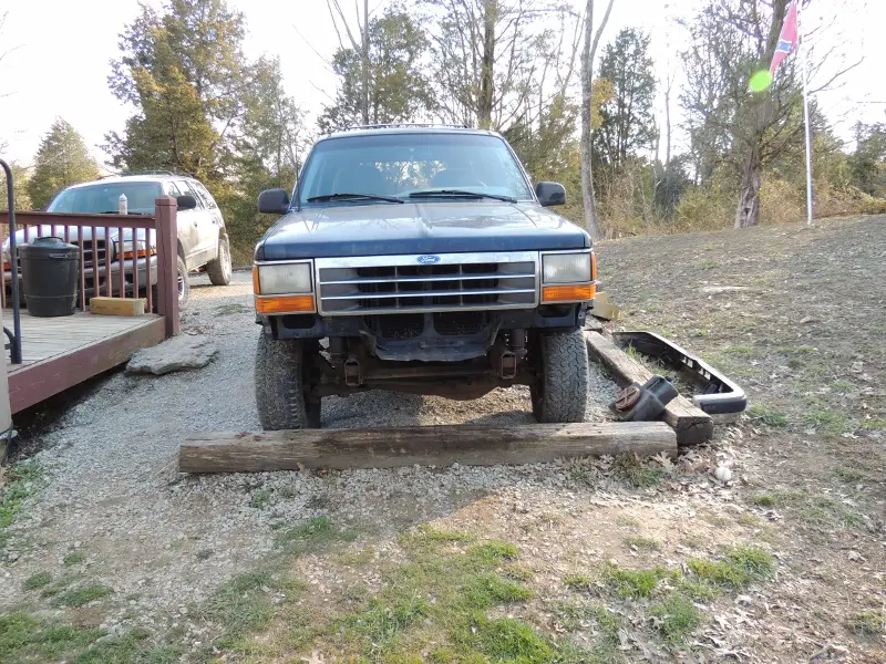

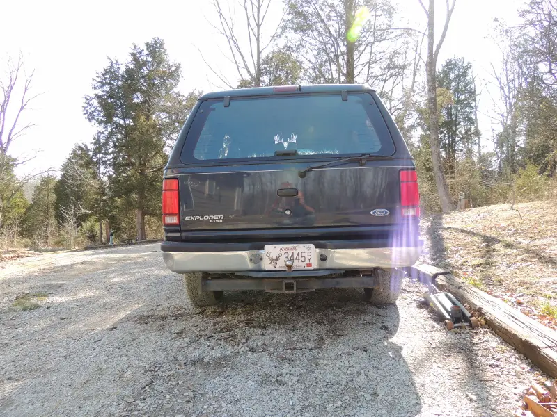

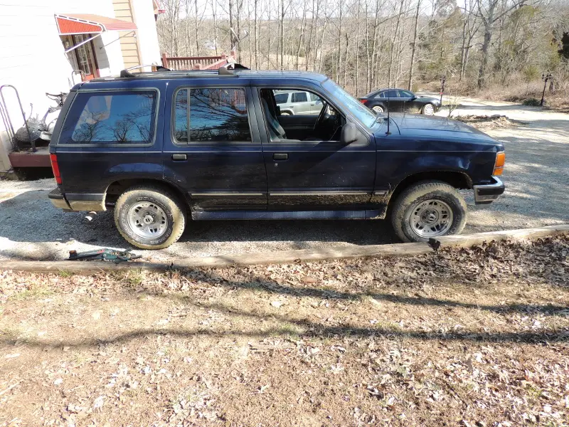

Before

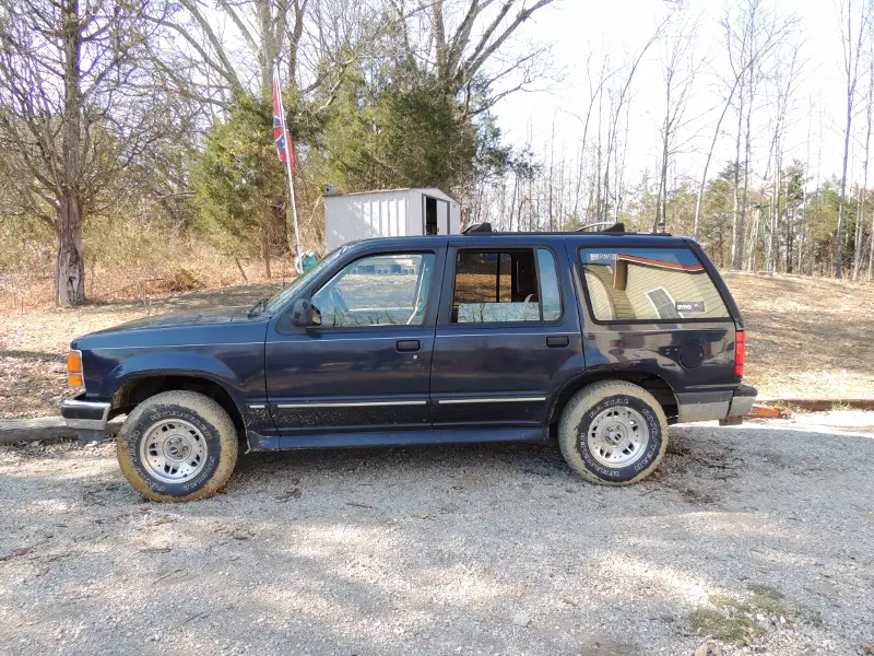

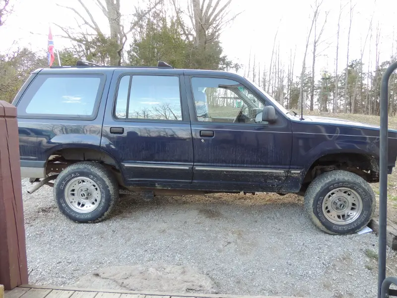

After
New wheels and tires Friday. I will post new pictures with the finished product.
