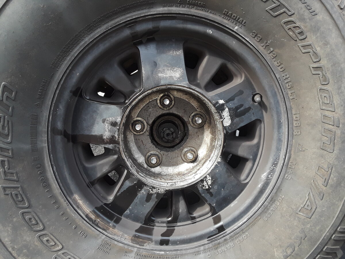

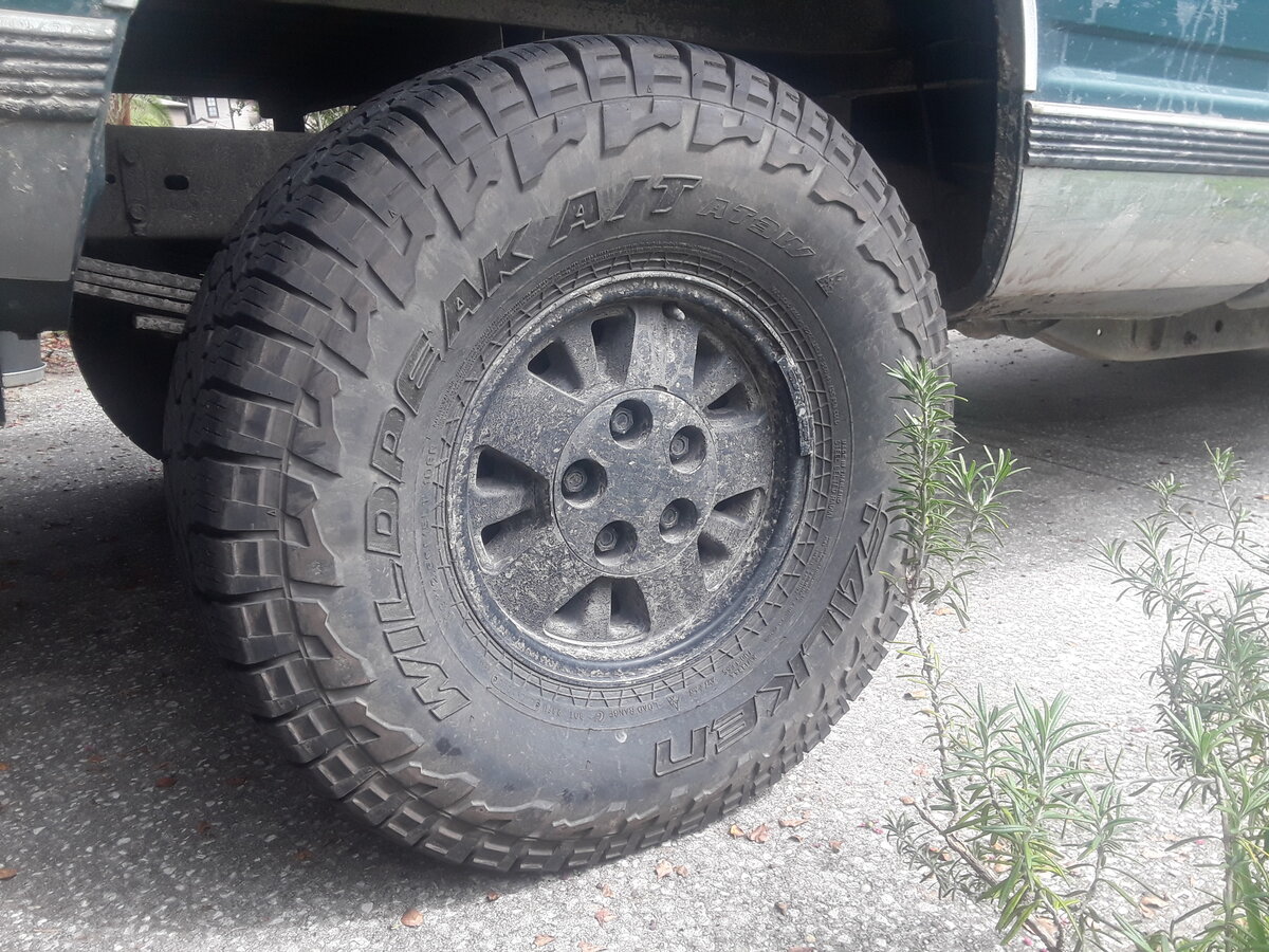

If ya look towards the bottom in each, both my all terrain tires, the Goodrich up front and falkens in the rear say M+S on 'em,both re very much A/Ts, but they say it lol

All the MS is telling you is that it’s not a summer rated tire. It doesn’t mean it’s intended for mud or snow use, just that it’s one of the manufactures all season tires.
I’ve had several sets of TAKOs, and they’ve all been great in the snow. Lackluster in any real mud.
