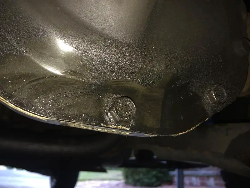

Could be the angle/light, but is sure looks like a pinion seal to me. It appears you have fluid coating the bottom of your differential that's running down from the pinion seal. Once it gets to the lip of the rear cover while driving, air kicks it up all over the place.
That is where I would start.
