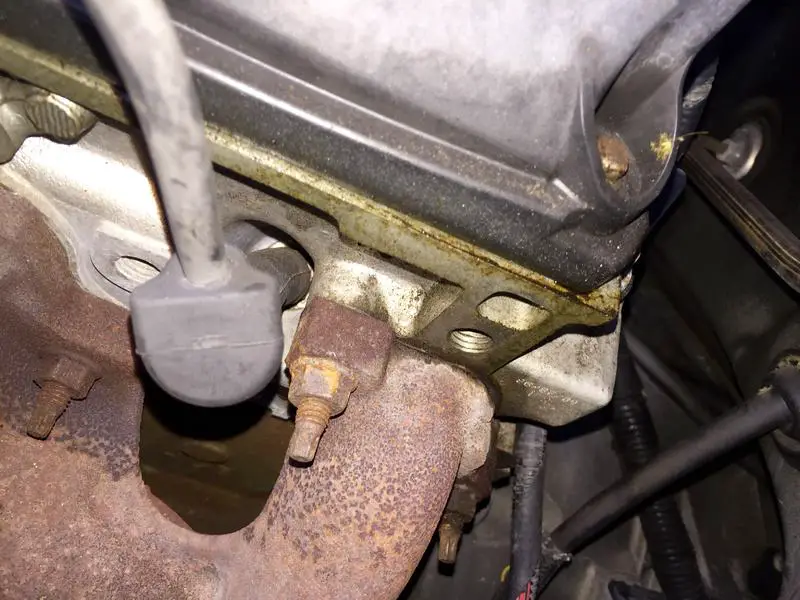

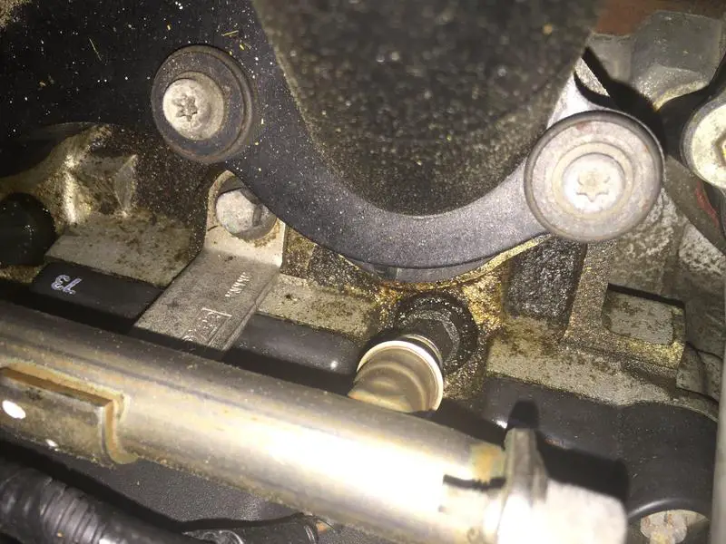

YOU NEED TO STAY AWAY FROM YOUR FORD DEALER. If it's the same place that did your timing chains those gaskets should be like new still. Also I have NEVER seen valve cover gaskets leak at the top like that, it's near impossible. Have someone turn the ignition key to "on" and watch that injector. Fuel evaporates so it's not going to puddle, just collect dirt.
Also if the pcv valve is bad it will suck oil into the intake manifold and puddle around the intake o - rings on the inside but also SHOULD NOT leak if those o - rings were replaced.
Get a printout of your original work order so you can see what you actually paid for and parts used. If the valve cover gaskets are not on there then they half-assed it for sure.

At most the only expense you should have is the cost of gaskets and o-rings because they should have been replaced in the first place while it was apart. Who reuses 10 year old gaskets anyway?
