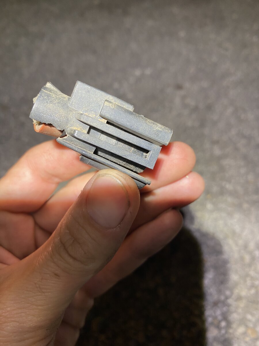

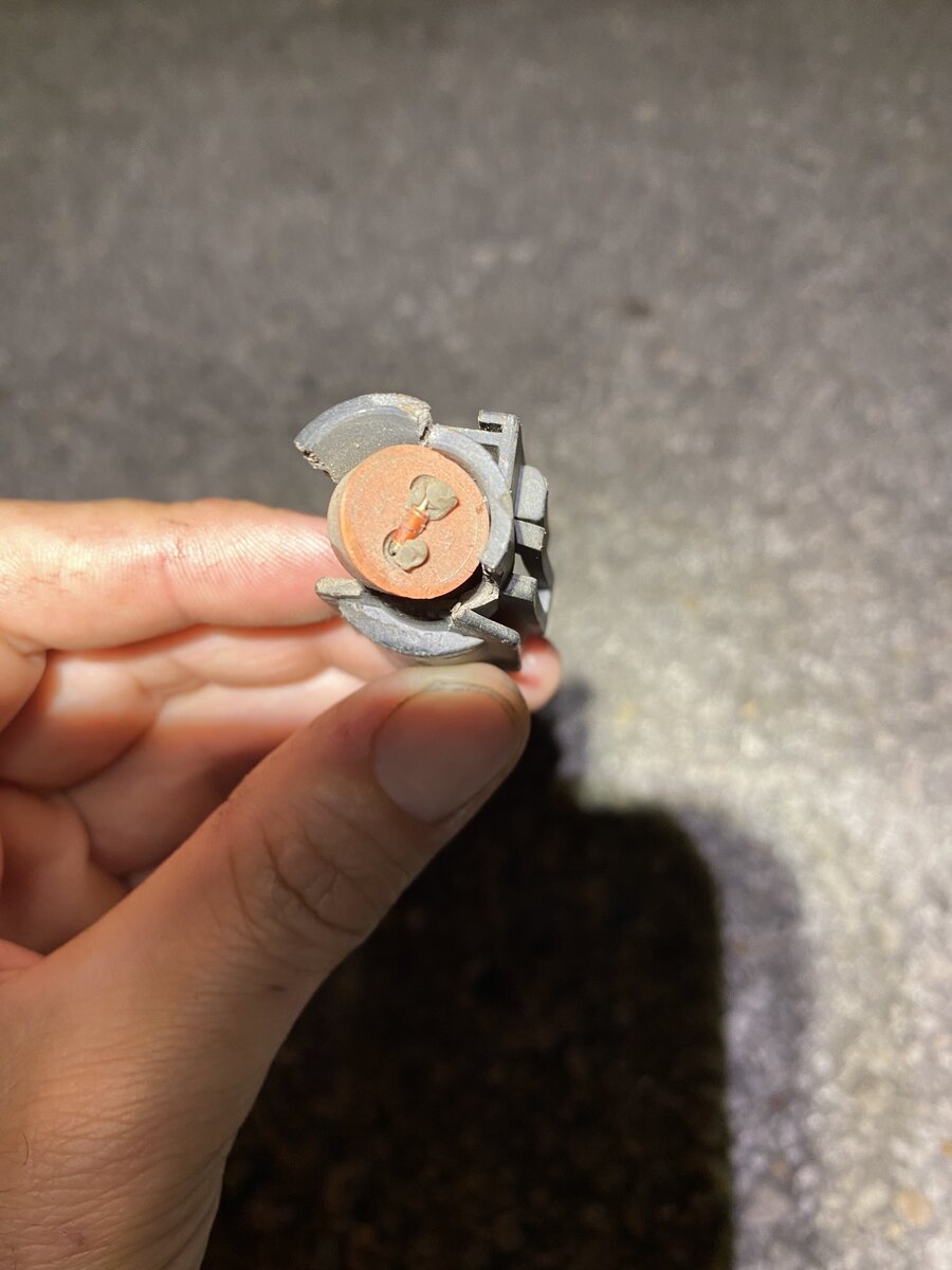

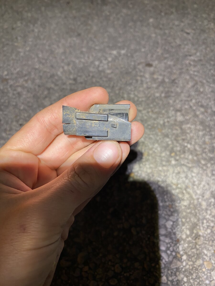

Can someone help me figure out what this sensor is? I hit a hog and could have filed insurance but my explorer would have totaled and I can’t have that so I got a front clip off a newer limited explorer from a pull a part. Mine is a 1995 Ford Explorer xlt and none of the ones at the pull a part had this same one. Mines broken so I don’t really know what it looked like. I thought maybe it was a ambient temp sensor but it doesn’t look anything like the ones on rock auto. This is the last thing I need to replace.
Thanks for any help.

That looks like an ABS sensor connector, which mounts on top of the frame right about where your picture has that broken one. There's a small hole on the top of the frame that the sensor pushes into, it has a plastic push in part that goes into the hole. The ABS sensors from the front wheels push into about three frame holes, running along the outer surface ahead of the wheel and spindle, ending just on top of the frame. Those will be the same on both sides for the ABS sensor wires.

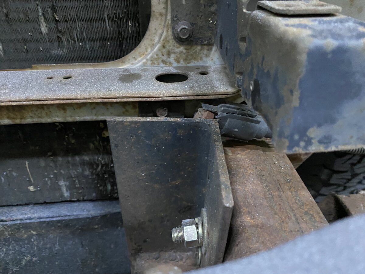

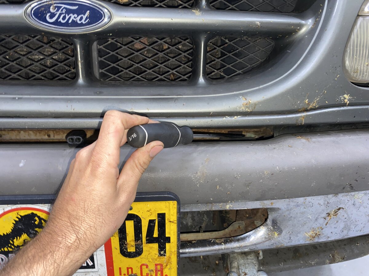

The connector does kind of look like a abs connector that plugs into whatever this sensor is but i took a picture of where it mounts and I just set it on top of frame to take a picture of it originally. The abs connectors are ok though and that’s all working. It’s between the grille and bumper.

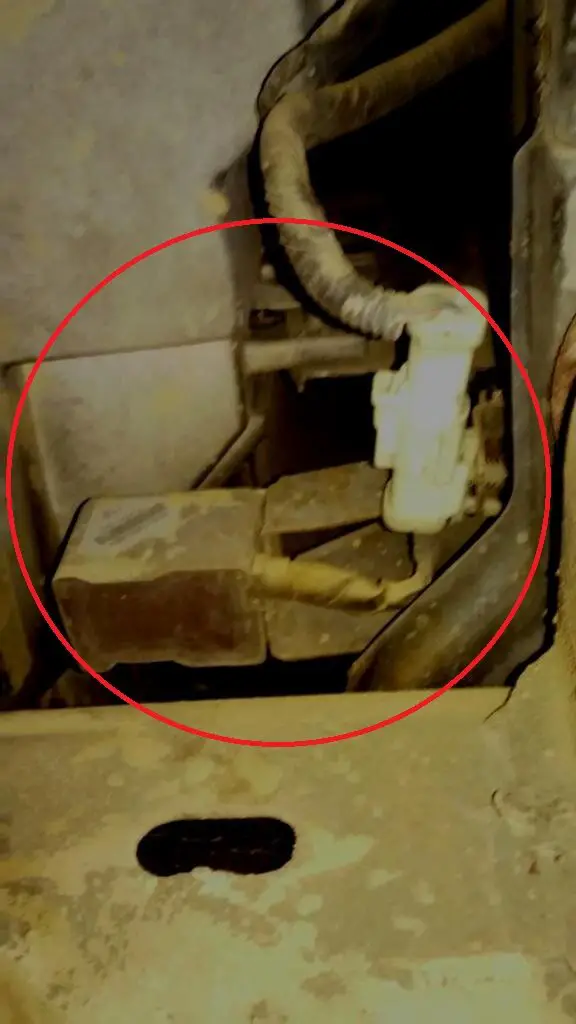

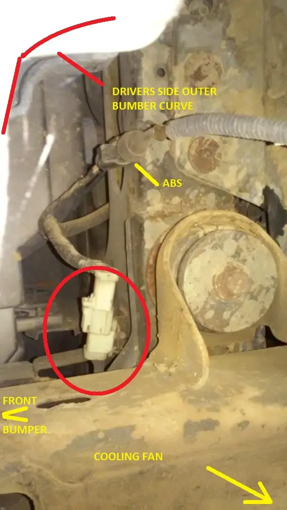

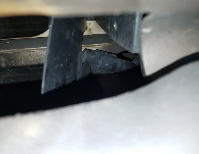

Here is all that I have in that area on my 95 .... the ABS connector and then unknown to me other connector in white going to/connecting to black block -- circled in red <<< maybe some other member can inform us both what this is ..... Your (faded) black damaged connector does indeed look like my ABS one in picture but you're stating otherwise... maybe my pics can shed some light on all this... Good luck.

There are a couple of sensors which look like the ambient sensor, they may both be, in that radiator area.
The color of the connector will help a lot, they are usually different colors for different functions, as much as OEM could make them different.
Here is what is in that area on my 96 XLT.

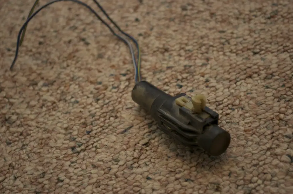

Here is a sample pic of what the backside looks like:
/\ So what is it ?
Outside air temp sensor for the overhead display etc..
That reminds me that i need to acquire one of them to install my console (plus a bit of wiring pigtail.
Same sensor as the dash gauge coolant Temperature
All use the same style sensor and plug
Really - exact same sensor just exposed to ambient air?
I'm guessing this one pictured is my air bag actuator / sensor....yes?
yes
look at the pic the wire goes directly into the airbag sensor
