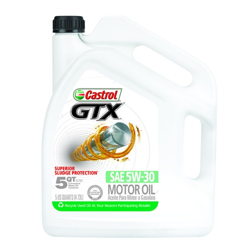

Welcome. No the 4.0 requires 5W -30. The 4.0 was never back spec to 5W-20 like some Ford engines were. Consider all the timing chains this engine has. Do good service intervals. Oil and filter are cheap compared to timing chain jop.
OR
Note. My pic of the Castrol is old. Castrol's 5W-30 is now a synthetic blend.
I've been using the Castrol GTX 5W-30 with a Motorcraft FL820S filter ever since I got my Explorer. Walmart sells both.
Before they switched it to synthetic blend I was changing it every 3,000 miles. Now I change it every 5,000.
I'm at 238K and my timing chains are fine. I must be doing something right...
