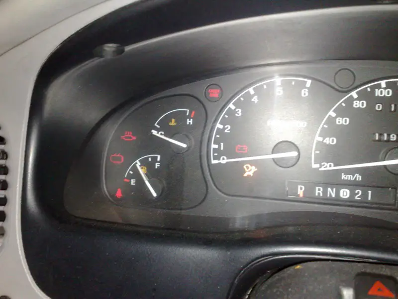

I have a warning light indicating on the dashboard next to the "Door Ajar" light on an Explorer 1997. But I can´t find out what it´s indicating anywhere. It looks like a tube with a thickening on the middle, with "heated-air-waves" over it. How does the catalytic converter warning light look like, my best guess is that´s the problem.
Interesting... That's a new one for me... Is this an export-model Explorer? (i.e. non-US version) Where exactly does it show up in the instrument panel? A wider-angle shot would help...
the OP is in sweeden. whatever it is its not something we have here in the states
I'm guessing by the shape of the light that it is indicating a catalytic converter problem
The UK-spec and German-spec Explorers both have some odd-shaped icons on the IP as well.... But their location (and the problem they indicated) was the same as the US-spec versions in both of those cases. That's why I asked about the location on the IP of that icon... It may give us another 'image' for the same error (or it may be something completely unique).
As for the location, I had to ask the OP because it could be a UK-spec Explorer or a German-spec Ex, or a US-spec Ex that's been retrofitted for european use... We see all kinds of stuff overseas, and there's no way to ascertain the orgin without asking.
edit: And I forgot to mention, I'm guessing that it's just to the left of the cold mark on the temp gauge.... In that case, for the US-versions, that would be the 'check engine' light... What does the owner's manual say? (I don't have access to export model data back that far)
German version of Check Engine
Of course! It seems to be the same location as "Check engine". Guess I´ll have to get myself an OBD-reader. It´s also correct it´s an German ex, I don´t have the original manual but the American I found says;

That could be the German symbol for 'Check Emissions System.... US equivalent for 'Check Engine'... You can see the one right below it being clearly a 'door ajar' light.... OUrs says, "door ajar"... Must not translate well (or short!)
