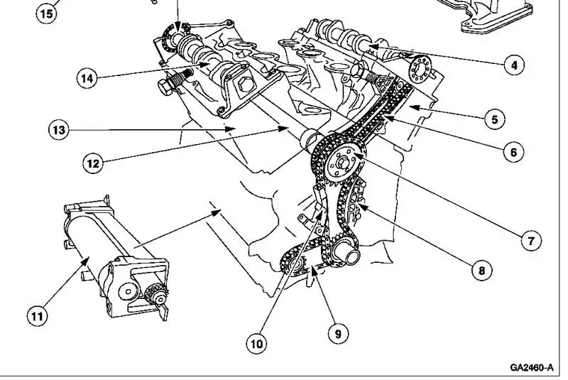

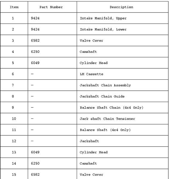

And finally, i read only the 4x4 has a balancing shaft. So, I HAVE to have an engine from a 4x4 correct?
