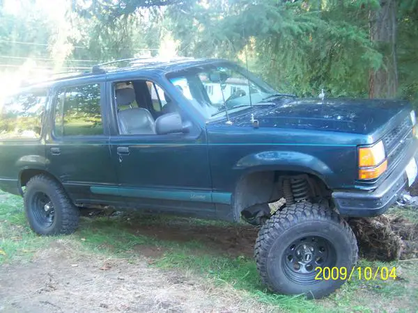

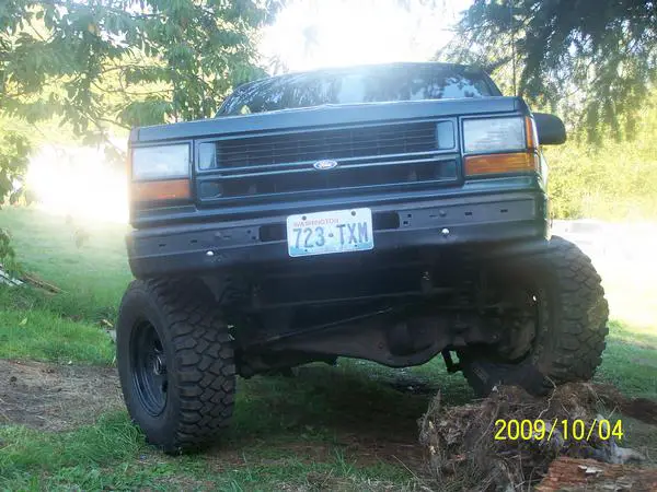

This is what i have now traded for this what do you think
and i got some ideas im gunna do to...
Now this summer i will be putting a 5.5 inch lift and fit some nice 33's idk if im gunna switch it to a solid axle?( yes/no??) and im gunna take the axle of leaf out and switch around to leave over axle maybe put a snorkel in and everything
will i need to change the gearing to make it have more power then i put the 5.5 on 33's on its got a 4.0 automatic its a little sluggish with the 31's but its got stock gearing any ideas to make it decent or anything else to make it a better wheeler/ dailey driver still.?
thanks

SAS is a great way to go. Just don't do what I did and buy a 5.5" lift first and then swap axles. Waste of money... Do a spring flip in the rear, SAS in the front with Early Bronco components and you'll be set.
Your current front axle can do well for you, but you have to be aware of it's weak spots. Mainly hubs, and the aluminum center section. The center section can take a lot, but not as much as cast iron.
i for got to mention that the guys switched it to manuel locking hubs.
The Dana35 manual hubs are much better than the autos, but are still a weak link. Those who wheel a lot carry at least one and often multiple spares.
