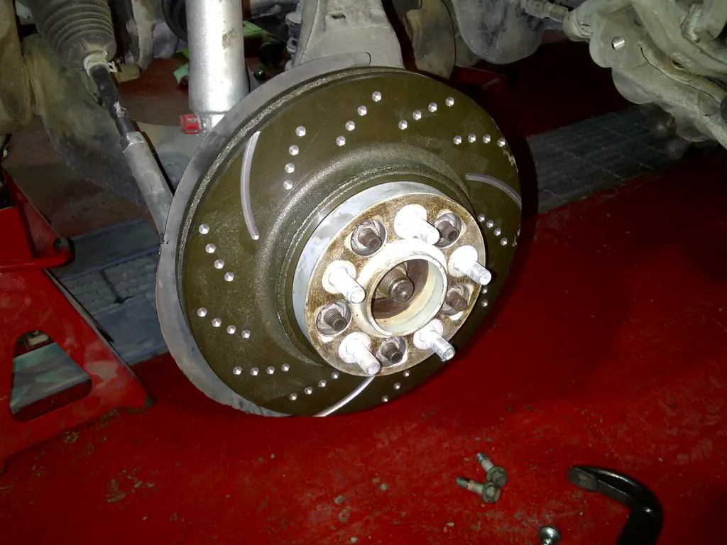

I use Eibach Pro 25mm=1" Spacer Kits #90.4.25.010.3, for a year now and I love them,
Just don't forget to torque them well and to use Loctite blue threadlocker on them

the Eibach Pro 25mm=1" Spacer Kits #90.4.25.010.3 are hub centric
a pair cost $145.95 at Summitracing.com
here are some photos
