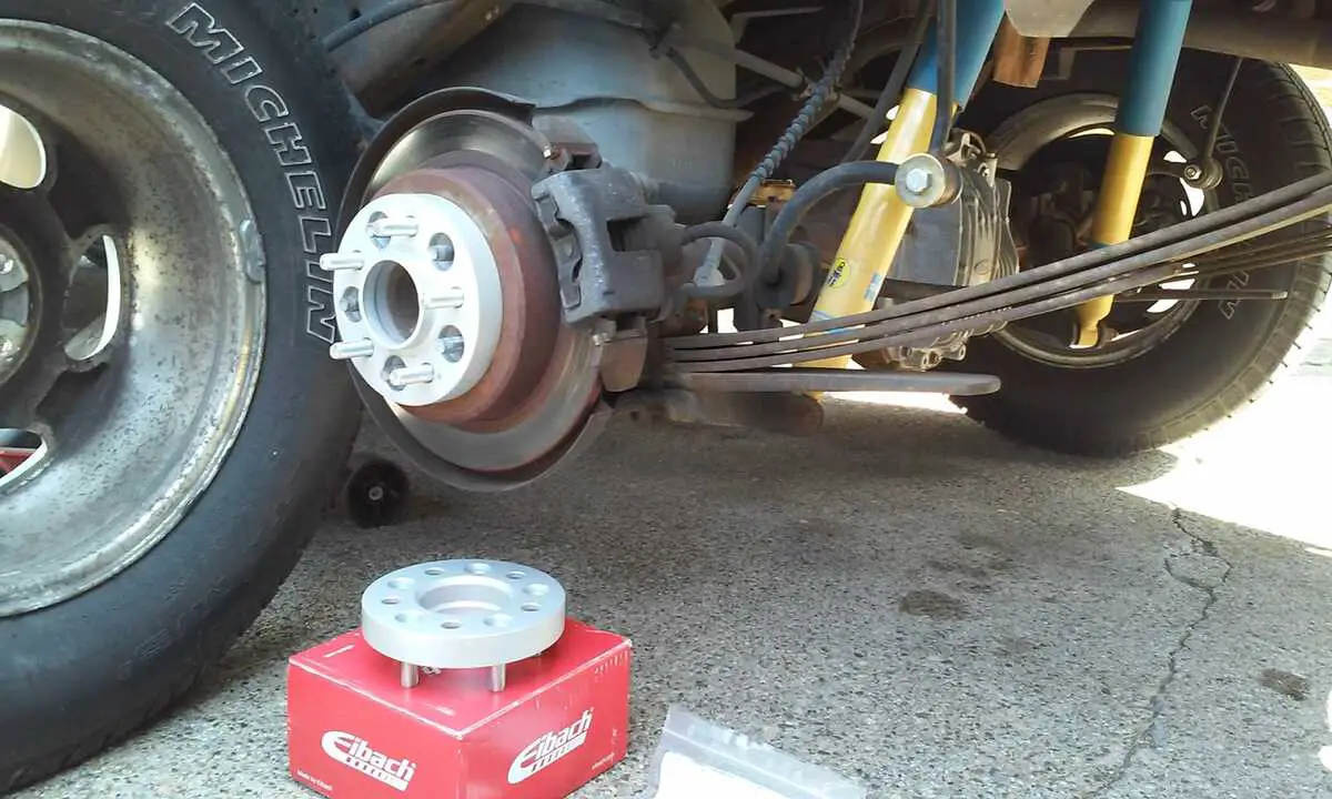

The studs are long enough with 1/4" cut off of them. They will be fine. Don't put a spare on the roof, it changes your center of gravity considerably and Explorers don't need any help in that department. Also, its a total pain to drag a tire onto the roof, and looks stupid. I did it for a few off-road trips many years ago and realized the Explorer had more body roll with the tire up there, and it rubs the paint off the roof. I really never cared how bad a spare tire looks until I put it on display on the rear bumper.
Spacers; I have them, but really don't like them. Just another thing to fail at the worst possible time. I am eventually going to get the C clip eliminator kit for the rear axle and order the new shafts in the correct bolt pattern.
