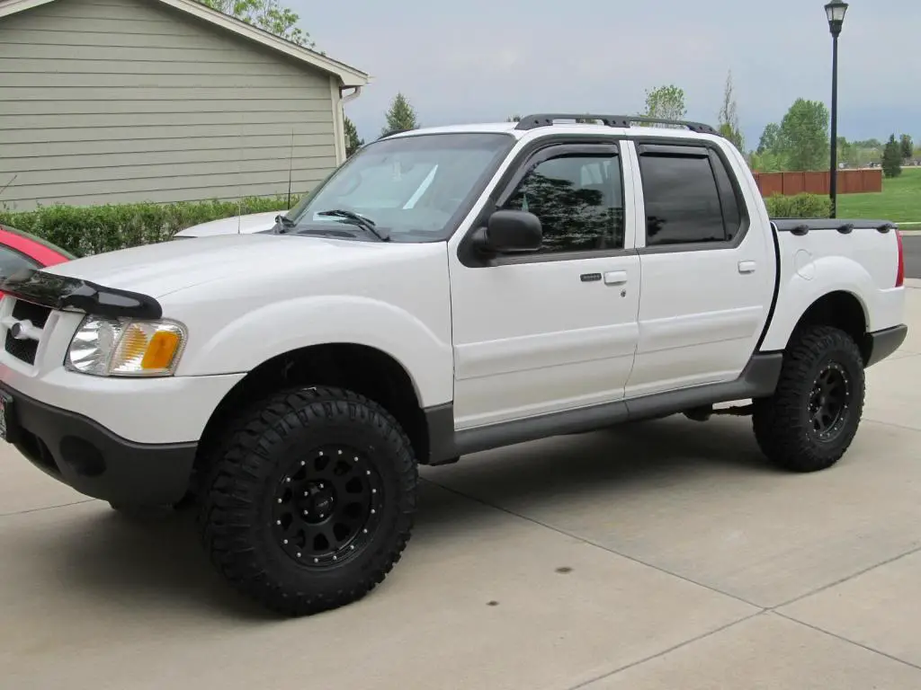

After researching many different tires, and even starting a thread, I chose to get goodyear duratracs 285/75/16 load range E. So far the tire is awesome, but I can't speak of how it does in the stow because I haven't had the opportunity to drive with them in the snow. My trucks still has power, just shifts a little later than before, my gas mileage wasn't really affected, and I haven't noticed any road noise. Plus I got my tires at discount tire for $190 each.
Not sure if you are looking for wheels as well, but when I got tires I upgraded my wheels to MB 352 16X8.5 5-114.3 -6MTB.
Not a great pic, but here is an idea of how my truck sits with only a body lift and new wheels and tires. No tire rub
