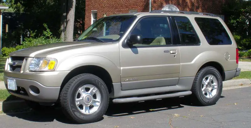

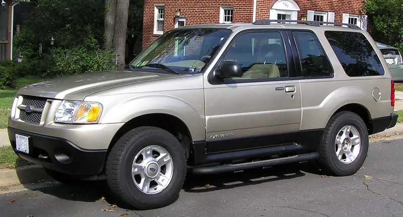

That looks really good! Nice job! :thumbsup:
