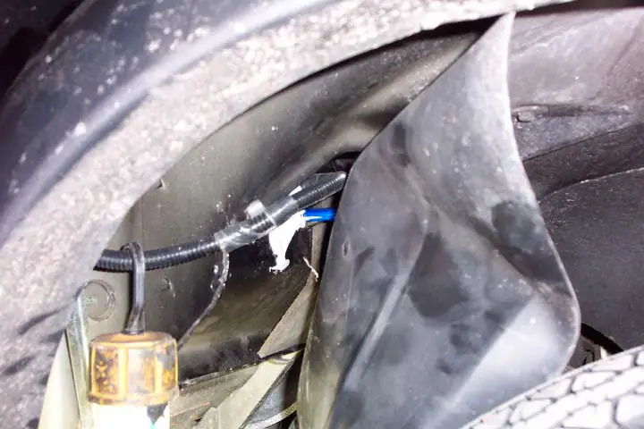

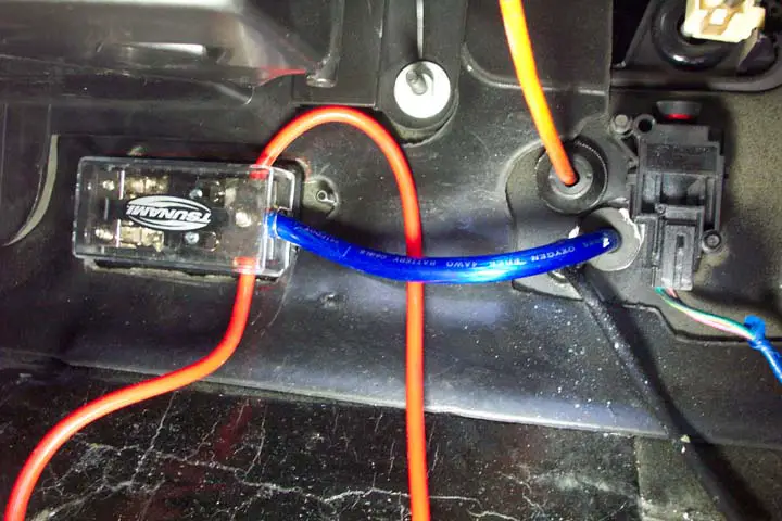

Here is what I did.
I have two amps. One under the passenger seat, one in the right quter panel.
I ran my RCA's down under the center console to the amp under the passenger seat.
and then to the amp in the quarter panel.
The power comes in thrugh the passenger side wheel well ( see photo 1 )
and hits a distro. ( photo 2 ) From there one wire goes to the under the seat amp and the other goes to the quarter amp.
The sub and the amp are both in the right quarter so that is self explainitory.
The speakers for the seat amp just go their own direction all under the carpet.

I ran my power wire through the firewall on the drivers side, there was a rubber grommet near the pedals that I cut and pushed the wire through. From there I ran the wire underneath the plastic trim that goes along the floor right next to the doors, then came out under the back seat and into the cargo area. I did the same thing on the passenger side for the RCAs except just ran them behind the dash to attach to the HU. Hope this helps answer your question.
