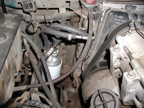

I purchased one of the remote oil filter mounts from Summit; the Summit brand.
Uses a standard PH1A I think.
This is how I installed mine:
Blacksheep Josh
Slinky+Escalator=Fun
July 31, 2006
3,668
13
Statesboro, GA
'01 Ford Ranger, RIP 93 X
For some reason I always thought filters had to be mounted vertically, but I guess not.
Only reasoning I have is every filter I've seen between my moms van, my explorer, and my friends blazer are all vertical.
Learn something new everyday

Perhaps a magnet that clamps onto the filter would be the most ideal too right?
http://www.filtermag.com/?app=Automobile/Light+Truck&year=2002&makes=FORD&=Model
Has anyone placed a magnet on their external transmission filter?
I actually did spend the money on 2 of those filtermags.
one on my oil filter one on my aux tranny filter.
has it done any good? I don't know; haven't taken one apart yet. Will it hurt? Certainly not.
Was it worth the money? Couldn't tell ya.
