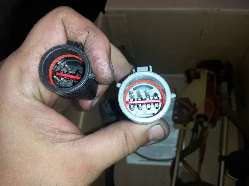

02 Explorer XLT V6 (not flex)
Doing a search for a new fuel pump shows me one with a 7 pin connector and 1 with an 8 pin connector. I'd rather not drop the tank first to find out which one I need, and plugging the VIN number into an actual Ford Parts website doesn't seem to net me any more definitive results. Is there an easier way to find out before I drop the tank?
The reason for fuel pump assy replacement is every time I get below a quarter tank, it doesn't want to start until it's cooled down (after it's warmed up), or I put enough fuel in to bring it above a quarter tank, then all is well. I'm getting fuel to the engine, when the fuel level is up tho. It kept blowing fuses each time as well. Just need to remember to keep more than a quarter tank of gas in there.
