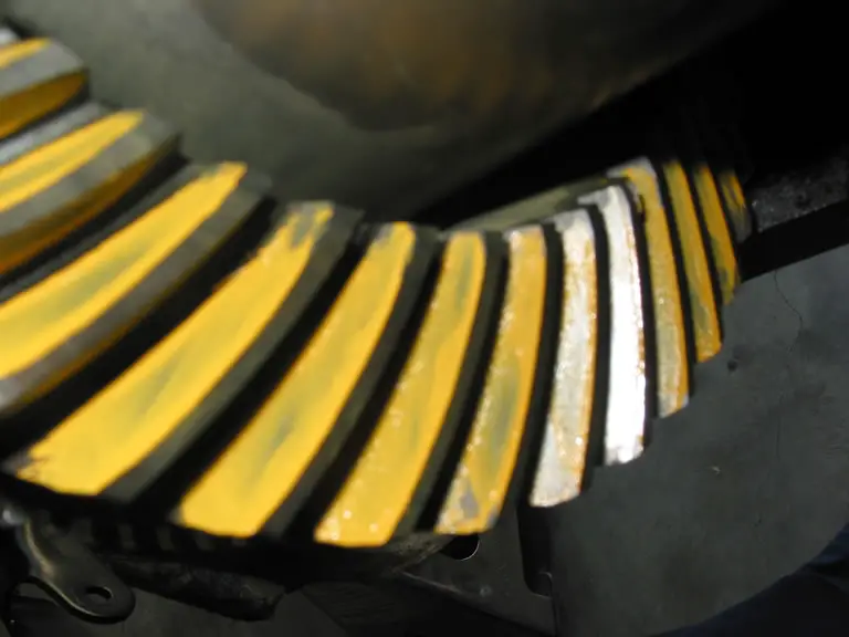

heres a picture of my pattern at the install

There are two different gear patterns. Forward/drive and then coast/reverse. The picture you showed above was only forward, there are two gear faces, you need to have a pattern of both.

here are the pics of the coast side.
