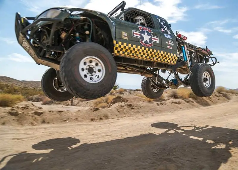

Well, I figured this would be a good single source to document my next project. I've just finished a 10 month race truck build and finally got it out of my garage and parked on the side yard so I can start my exploder next!
