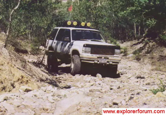

I have (2) pairsof KC daylighter on my roof rack and I love them.
As soon as I throw the switch its like the night turns to day.
Here a picture of them in the day time
Sorry no I have no night time shots
