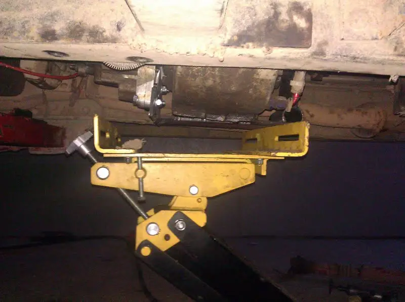

Making Progress. It's a little tight, but it all fits. I will have to make the final adjustments and bends once the t-case is back in the truck. I am currently waiting on some small parts, but I am starting to see the light.

Made a little progress today. I identified the initial clearance cuts under the truck while waiting for Alicia to wake up :rolleyes: and after I got home from swaping a 4 planetary gear t-case for a 6, I sealed everything up and got things ready for the final install and crossmember fab.
Tomorrow I will start hacking away at the excess useless metal under the Ex to make room for the drivetrain.
Well I did a test fit on the t-case last night and found that it is hanging about 4 to 5 inches below the frame rail at the back end. That is a little lower than I like so tonight it will come back out and I will beat the hell out of the bottom of the body with my BFH to make some more room.

Holy crap my arms feel like lead. Just spent the last half hour pounding away with a short handled 8 lb sledge while laying on my back. I can't even feel myself typing right now.
Final test fit and install complete. I was able to get it tucked quite a bit further up in there. I now have 1 1/2 to 2 inches below the frame. It will be closer to 2 once I fab up the mounts and it settles on them.
I am happy with it since it seems to be the same or maybe even a little better tucked than it was with just the Atlas.
