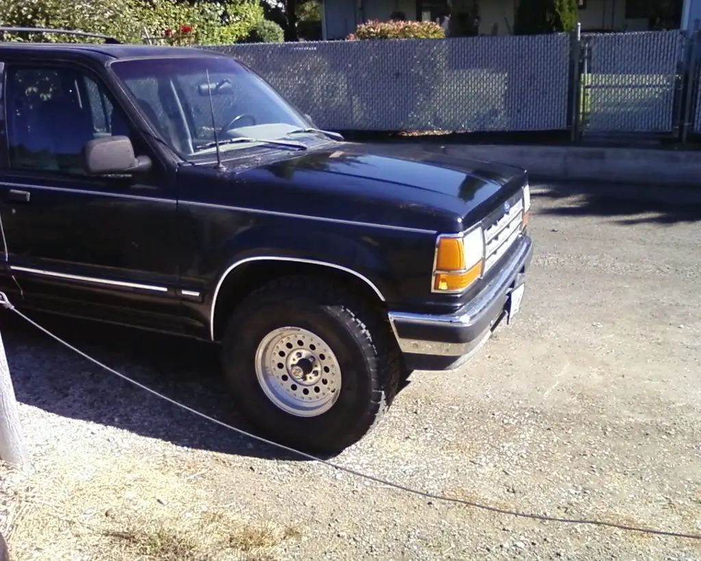

33 x 9.5 x 15 fit. No trim. No lift. I'll post pics as soon as I find my camera.
There is a very slight rub on the inside rear of the front fenders when the wheels are turned to max lock.
If you weren't actually listening for it, you would never hear it.
So unless my truck is somehow unique, they should fit on any other one.
Now I must go poke fun at Les Schwab, Advantage Tire and Ed's Tire Factory. They all swore they would not fit without "massive" trimming or lift.
Forgot to mention, I just trail drive, I don't rock crawl. So unless I somehow get myself into a really bad situation, I wont have to worry about turning while flexing the suspension. Also, there is still 2" of fender clearance and another 2" inside the well.

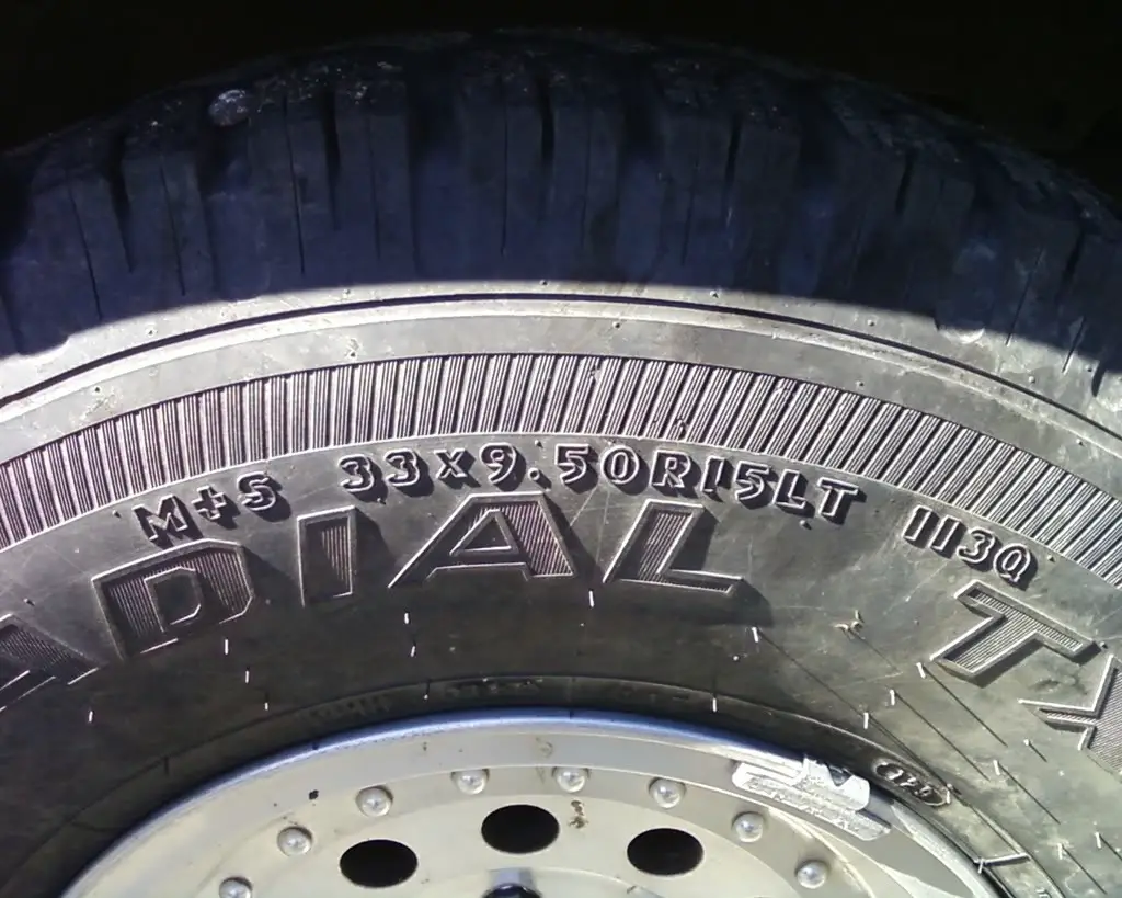

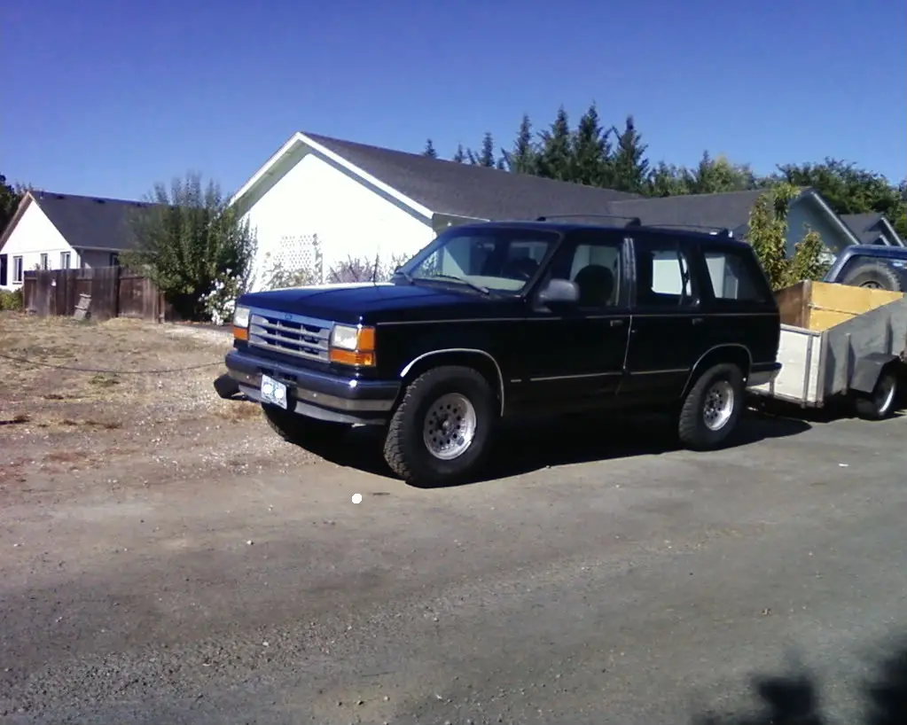

Uploading pics to photobucket right now, they have about 75% tread left. Still have the "tits" on the sidewall so they aren't that used.
They're not great quality 'cause they were taken on my phone, but still good.
I have pictures of it flexed out with the 33's but they refuse to come off the phone. If worse comes to worse, I'll take the front anti-roll bar off again and run down to the rock pile at the ponds.
Sidewall
:D
:D
White spot on the ground is where I accidentally clicked when I "blipped" my plate. Touchy mouse.
