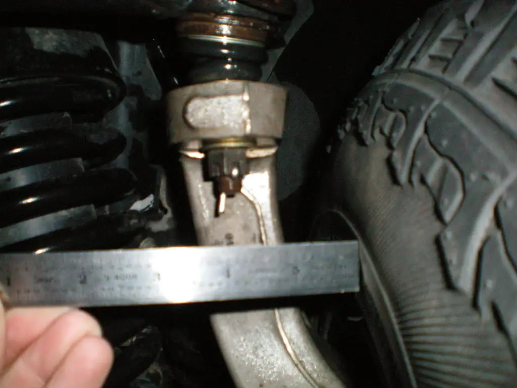

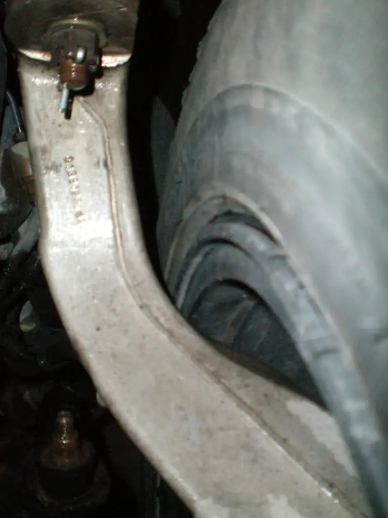

Judging by my wheels, 6.2" of backspacing will be too much and will most likely rub the steering knuckle.

The rims you are considering MAY fit your truck without wheel spacers because they are a 20" rim and because the steering knuckle kinda angles back from the rims, you would have more room than my rims, but that would be a gamble on your part. If you can afford to have your truck down for a week, then i'd say buy those rims and see if they'll fit, if they don't, buy yourself some wheel spacers and wait for them to show up :popcorn:
My rims are 17x9" with a +24 offset and 6" of backspacing. i can barely fit my finger in-between the rim and the steering knuckle.
here are pictures of my rims and the clearance to the steering knuckle
