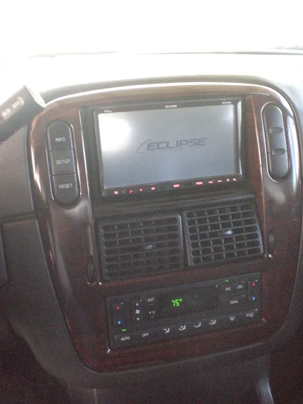

My Eclipse D-DIN was super tight, but nothing a file couldn't fix.
Aha, this guy's happy! :)
