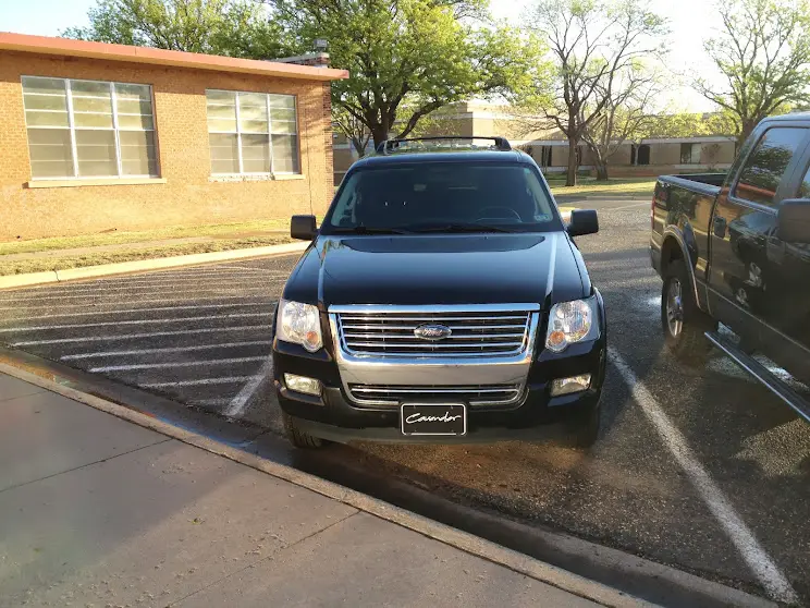

Meet Black Betty.
My new 2010 XLT. Its a V6 4x4 with third row and rear air. Black interior. I've had her a little more than a month and I really like her. I'm still keeping the 01 though because its faster, it has more towing, and it honestly handles a little better (according to my buttmeter). And this new one should give some more time "modernizing" my 01!
