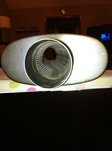

Also received my new 3" straight-thru full boar muffler (404SS):
