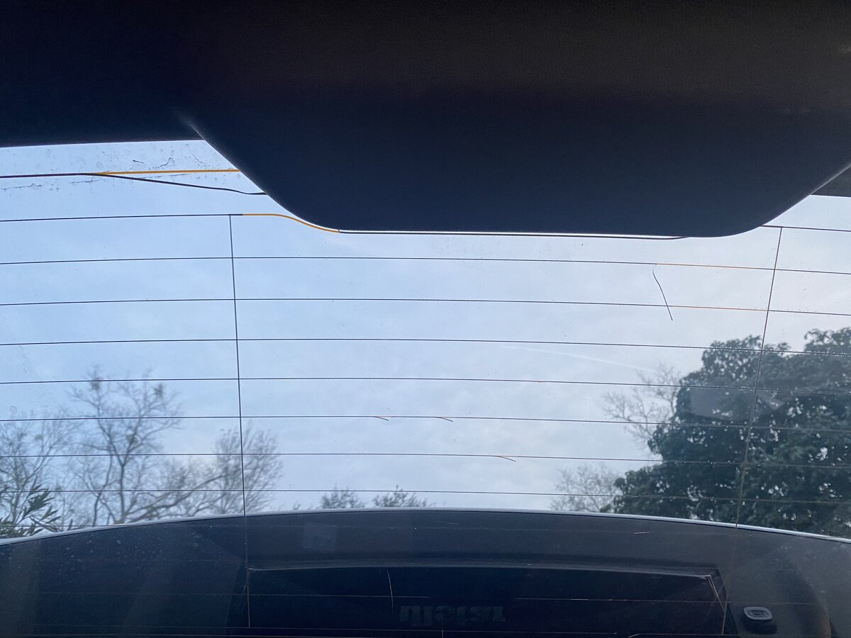

Wanted to get my windows tinted today. Started a walkthrough and opened the rear hatch. Was a little dark but the tech got a light and we looked at the windows to show me an example of the darkness level of the tints. Upon a closer look we saw the the elements of the rear defroster were different color. got even closer and it appears that the metal itself is falling off the glass itself. No Bueno at all.

.......... Upon a closer look we saw the the elements of the rear defroster were different color. got even closer and it appears that the metal itself is falling off the glass itself. No Bueno at all.
If that is the case, go back to the dealer.

I did no one seems to be able to tell if it's a bad application or if to was just a protective paint or some sort. So what we are going to do is wait till i have to defrost my rear window and see if it works, spotty or nothing at all. They took pictures to report to ford.

Interesting enough my front window cracked from the very top through the rear view mirror and down the passenger side in full view. Once I noticed that I looked back and noticed the peeling on the rear window. This is a 2021 and it’s been in the shop a total of 4 times and now this. I don’t use any crazy cleaning sprays on the inside. Usually just water a d a damp rag. This just blows my mind why it would peel! Anyone else having the same issue?

Actually, a second look makes it seem like the element didn’t stick to the epoxy.

I'm having the same issue on the 3rd row side windows. Initially, I thought there was a spider web in the vehicle but no, the heating elements simply peeled off and were hanging loose. I will have the dealer eventually inspect it but since I'm in Florida, this is fortunately not the most important thing for me.
