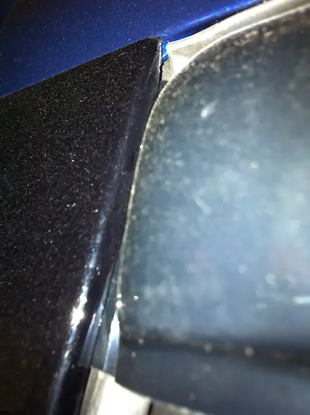

The directions to me were a bit unclear when it came to the rears. Does the front tab or the rears just go behind the gasket in the channel or does it slip in between the outside rubber and the gasket? I couldn't get it to fit real well in between, but in the channel it won't let the window go up.
The front tab goes between the black plastic B pillar cover and the first weatherstrip. Not in the channel itself. It kind of confused me at first as well. Take a look at the photos, hope they help explain it better...

@ModMiFord
-- excellent closeup on the pics.
-- and as you pointed out to others "You need to be exact with the instructions..."
-- as others have already posted, you "will" run into issues if you don't follow instr
-- on our previous ford, I put them on wrong and i vowed never to by AVS again...until someone pointed out my err. Now me and AVS are friends again :))
-- sry to others who are having issues, but plz take a close look at ModiMiFord pic closeups
Thanks!
