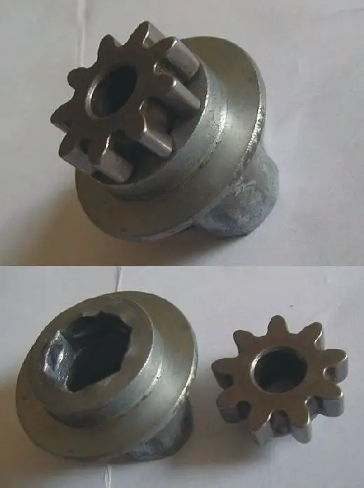

Just FYI... I found the problem.
Those of you who have taken these things apart will recognize these parts...
The bottom side of the steel gear has six sides,
is supposed to fit Tightly inside the bigger round aluminum part,
the inside of which also has six sides.
Well, the problem is that I could manually turn the gear while holding the aluminum part. That ain't s'posed to happen. You can see that the inside of the molded aluminum part has been "rounded" by the steel part.
When operating, it Sounded like the familiar "busted bushings" problem.
The solution?... I bonded the two pieces together with J B Weld.
Works like a champ, now.
