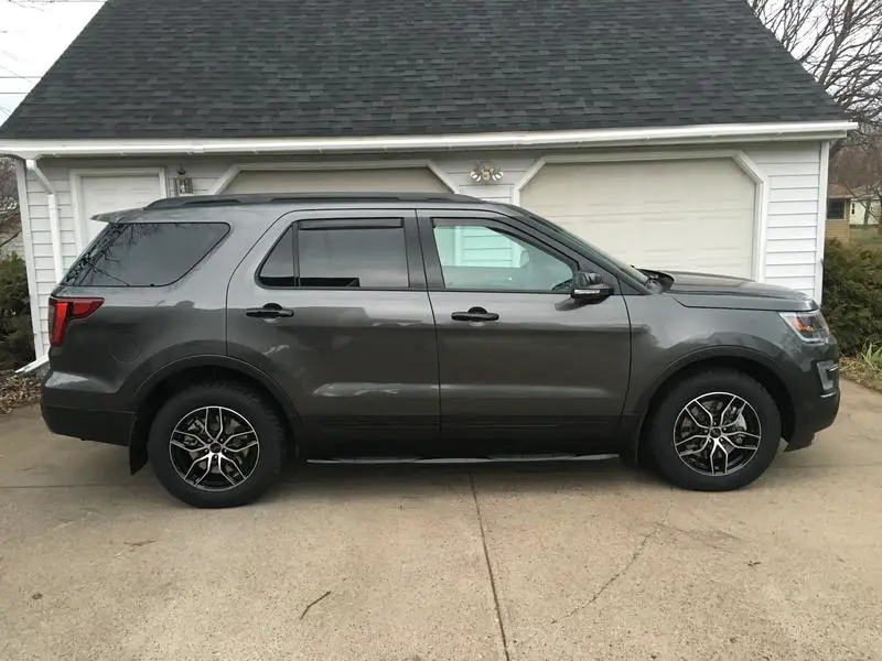

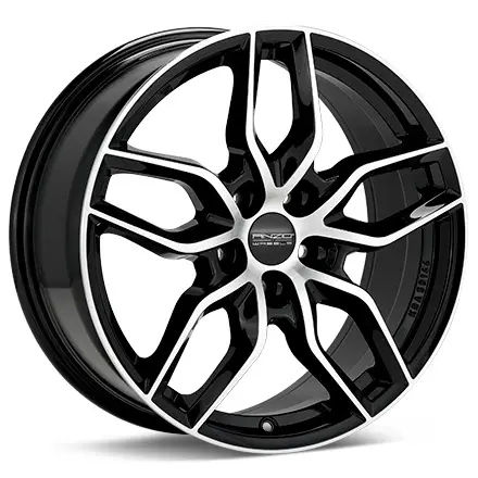

I actually just went on Tirerack.com and ordered a set of 18" winter wheels with TPMS that came to just over $1400 with rebates. I think I matched the OEM 20" wheels pretty well with 18" Anzio wheels. I like to try to keep the OEM look.

Wow, nice find!.

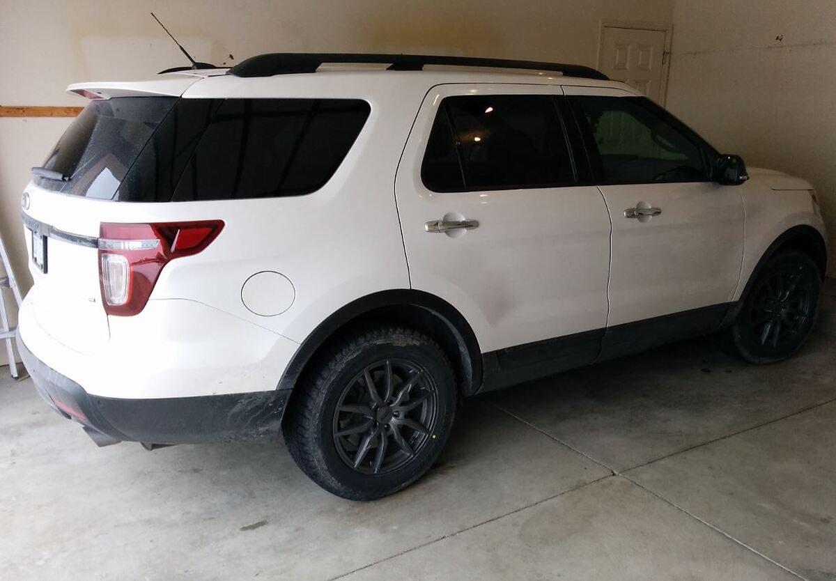

Hi everybody. Just wanted to share a few pics of my winter tires/wheels since I finally got them and installed them the day before our first snowfall. Apologies for the mud; went to pick up the Thanksgiving turkey and the turkey farm's parking lot was a mess.
I figured the "Matte Graphite Silver" wheels would show less salt than black and be more unique than plain silver, and 18" saved some cash of course. I really wanted the Interceptor wheels with OEM center caps, but even going to Canada to get them they would end up being much more $ and effort. So TireRack for the win. $1,504.28 including shipping plus TPMS. Not bad.
Anyone else have problems with the retaining rings for the hub centering caps? After getting the first wheel on with difficulty and the retaining ring for the second wheel popping off 5 to 10 times, I said screw it and left off retaining clips for the rest of the wheels. So far no problems, but I can't believe how easily those clips popped off. Either they're unnecessary or they should stay on better.

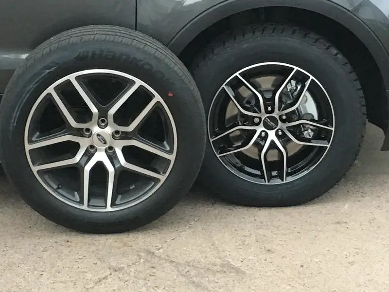

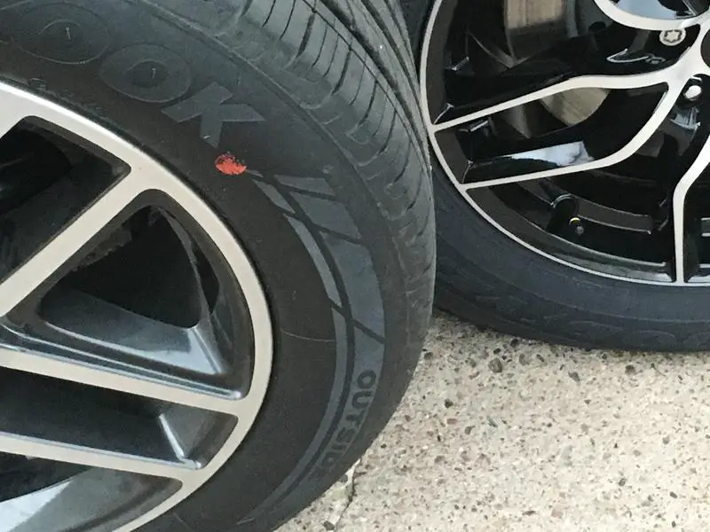

Got the wheels from tirerack.com today. I got them put on and trained the TPMS. The OEM wheels are a dark grey rather than the new ones which are black.

Very nice Jason. Good looking wheels.:thumbsup::thumbsup:

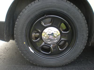

Those are the lugnuts (3/4) that I have on mine and as for the "weird looks" with the siny caps, I have not had any at all. In fact all the police vehicles around here and the ones I see on TV have the same setup that I have. No one has even asked about why the caps on a Lincoln have Ford stamped on them.:D
