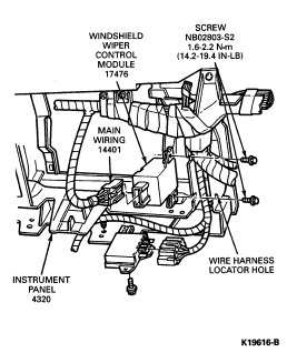

Wiper control module / governor service instructions
I also had the problem with the wipers only working on high, and not parking. It started as an intermittent problem which got worse and then quit altogether.
The problem is with my 1st generation Explorer (1991-1994). Just like another poster, I found the problem to be a bad solder joint in the wiper control governor. Once I found a diagram of the module location and a picture of the module, and gathered the correct tools, it took about 10 minutes to fix it. I thought I'd post the info here to help fill in any blanks for others who come across this problem, since I started here on my quest for details.
Obviously, this info is for after you determine that the module needs fixed or replaced. I looked through the forums here for help when I was making that determination. The biggest hindrance to my effort to find and fix the problem was with all the 2nd generation Explorer postings in the 1st generation threads. Thanks guys, but no thanks.
Tools needed: 7mm socket (or appropriate torx), ratchet, extension, small flat bladed screwdriver (to pry wires and also to open the module once removed), solder pencil & solder if the problem is a solder joint (or replacement module). I used a battery operated drill as well.
#1 Look at the pictures. It took a while to find them, but they really helped me. Search Google Images for "94 explorer wiper governor" if they come up missing in this post. The assembly pic is as viewed from inside the dash.
#2 Remove the plastic panel that is underneath the steering column (2 screws)
#3 Remove the metal plate which is underneath the plastic panel (4 screws)
#4 find module (to the right of steering column) & pry wire harness loose to allow access to the module's screws
#5 loosen the screws but do not remove the screws (2 screws)
#6 slide the module off its mount and detach its wire harness
Fix or replace the module and reverse instructions to re-install.

Followed this thread and a few others on trouble-shooting my wiper. Went straight to the module after reading all the histories. One site had various suggestions for getting to the module but none mentioned that the mount bracket could be removed to more easily access the screws holding the module.
Once you remove the plastic panel (2 screws) and the metal shield (screws), a 10mm nut is visible on the right side structure and another sheet metal screw on the lower right edge, just about below the left side of the ash tray. Remove these two fastners and the whole bracket drops free enough to easily access the module screws (mine were not torx, they were 7/32 hex). Whole process, about 15minute once you figure that out!
Mine was also a bad solder joint. Since this seems to be the primary failure, one must suspect over time current draw melts the solder joints. Only the power input to the relay was melted on mine.
Total time: module out 30 min; drive to Walmart for $10 soldering kit -30 min; solder 10 min (most heating the iron); module in 15 min (included re-removing lower panel, shield and bracket I had re-installed).
