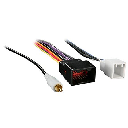

Hi all, I have a 2001 Ford Sport Trac and I'm trying to replace the factory stereo (I have the factory sub).
My new radio has a white and red rca plug (in and out I think). Can you tell me if I need the Metra 70-5517 or the 70-5519?
I forgot all that stuff but if you got to Crutchfield.com and try to purchase a receiver, it will suggest the correct Metra adapter to use, depending on with or without subwoofer.

Hey all. I'm going through the same issues from this now 19 year old post, but now I can't see any of the pictures you all mention here. Is there somewhere I can see these pics? justin146, I think I have the same harness adapter you mention; white connecter w/ red/white rca jacks & 4 other wires; blk/blk-w/blu/blu-w. The black rectangular JVC connector is connected to the factory harness (former owner cut the wires & butt connected them in) but there's 2 other connecters that aren't attached to anything now; 20 pin red & 16 pin red. Got a Goodwood Pac8 sub to replace the rotted out factory sub & wanna get this thing bumpin!! Can anyone help me with the pics & any other updated info about this? Thanks!
