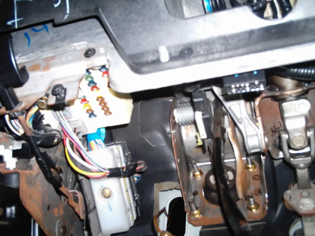

Caution re-using old hard wire loom. I had a problem with my meth system acting up... had to tear into the electrical and found two wires sliced from the hard edge of an old loom I used.
Yes engine wiring does not have a long life like older cars used to.

Here is what my new harness turned out like:
BEFORE:
NO WIRES:
AFTER:
That looks great. Did you make a grommet for that oval shaped hole? Use Ultra Black to fill in any gaps where wires go through or near edges, or the firewall. The RTV becomes strong and stiff, but still flexible, for years and years. Regards,
Thanks
Yeah im glad you reminded me about that grommet... I just saw it, I need to cut it out and get it back on. Good idea on the RTV... got lots of it.
It's great, it makes a permanent seal. I have sealed a lot of holes in trunk floors etc. where someone mounted something with sheet metal screws. You would be amazed by how much dust etc. gets through the tiniest holes.
