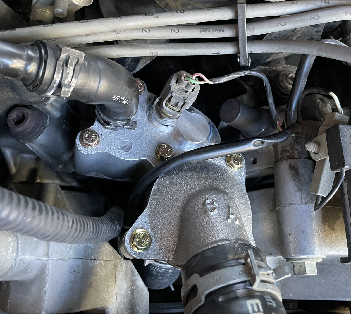

Got my first leaky thermostat housing and went ahead and ordered the Simmons metal housing, and bolts, new motorcraft thermostat, & motorcraft bypass hose.
Hoping I can just drain a little coolant and top off after?

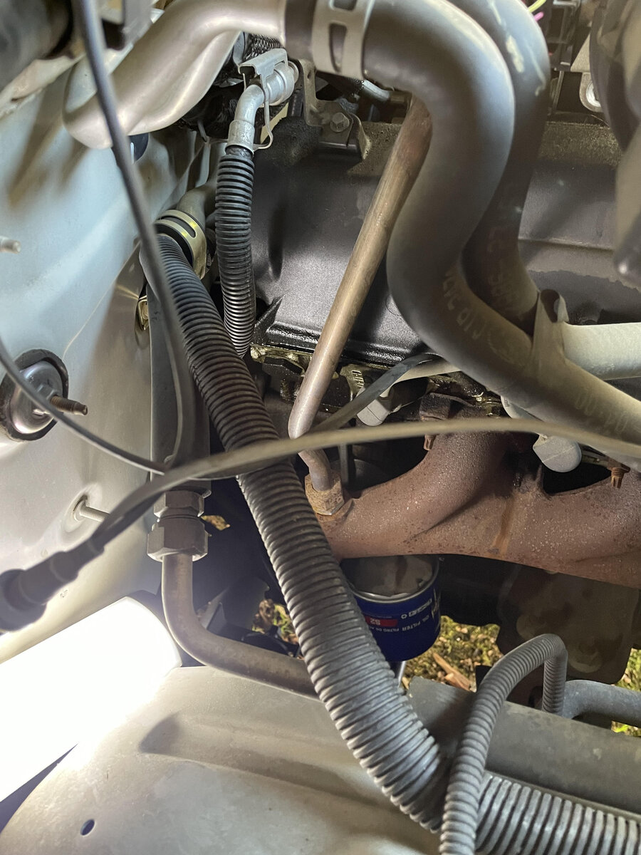

Also on the rear tensioner, most how to's on that seem to instruct to take off passenger wheel and trim inside wheel well, but it looks totally accessible from the top to me, just like the spark plug its next to. Am I missing something or is it just the difference in year models/features?
Correct
I can get to mine On my 99 sleeper just by removing the tire and the rubber splash shield
On yours the egr tube and valve may be in the way
Was on my 04

No rear ac. I was considering that- warm up car a little. I am tempted to try from top without removing wheel. (attached a pic of how spacious and enticing it is from top)

Yes the egr tube will need to be loosened up at least for me it was
If you heat up the block, you may be able to get it from up top. What’s difficult is keeping pressure against the engine while also trying to break it loose.
If you turn the wheel to the right, take out the wheel well, you can get at it from there.
Your biggest issue will most likely be breaking it loose. It’s probably 1/8-1/4” head to grab. Not much, so it’s easy to slip/round it.

Well, got tensioner and new housing/thermostat in. So far so good. One bolt scared me a little on housing with a creak but they all came out intact not looking too bad. I wimped out on replacing the bypass hose to water pump as access to those clamps with my channel locks was not happening.
32+ ft lbs for tensioner and w/new gasket washer. I hand tightened most of the way. Then 32 didn't feel like much.
89+ in lbs for thermostat housing.

I may have abandoned the idea of doing the other external tensioner from the top, mostly. The angle is sort of weird. But it's really not that much torque.
