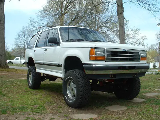

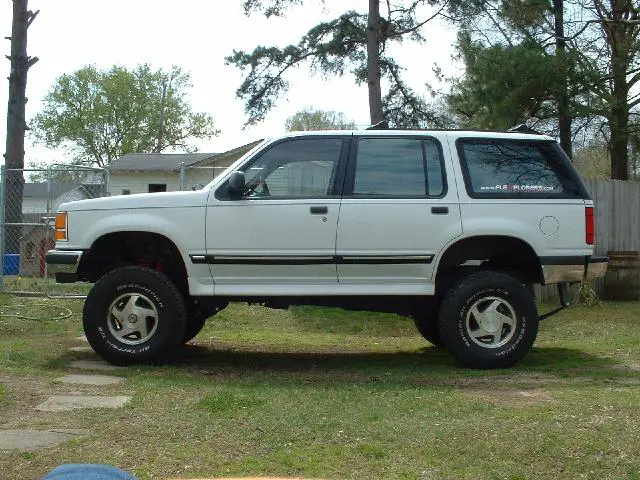

side shot, total lift 9 inches, and 33 inch tires
another
one more
Thanks,
Still gotta get the wheels on it, and a few accessories.
David
Holy shot, you need 35's, lol
Looks good, you better hurry up wearin down thoes 33's :D
Damn that looks good!!!
You are making me wanna put a body lift on real soon
Ryan
Hey what's with the colors?:confused:
Yomie, yeah gotta wear em down first, probably over winter I can get 35's, too much spent right now to switch, but who knows, things may change.
Ryan1, I knew if you saw it, you would want it, even with 33's it has a good stance, rides well too. I think once the crawlers get on there it will look better, and handle a little better.
are you sure that is a 6 inch lift? it looks like my 92 when I added the 4 Inch before my 3 inch Performance Accessories Body lift. I just wanted to say that it look me an estimated 20hrs to put my body lift on. The suspension was easier. Everything was rusted on and The brackets to relocate the front and rear bumpers don't work without fabrication. It took me a full day to mount them, I had to cut a notch in the rear frame to slide the bumper into. My own blood and sweat but it looks good. If ya need help im here. good luck!!!
