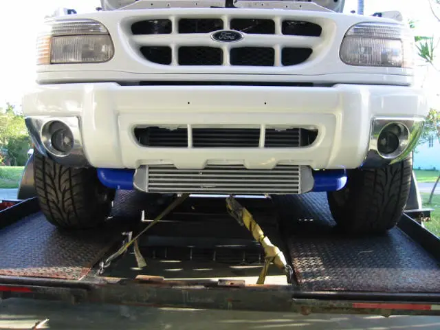

Dude, that it GORGEOUS. IMO, it looks great with the intercooler hanging down like that. I don't know how much you like it though. Leaves some mystery to it and makes people wonder what the hell you've got under the hood. How many lbs are you planning on?

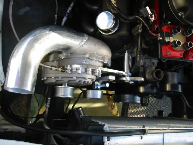

Bout time you got some pics up Dom! Looking real good man! Like the shiney new XB-1A. I sure cannot wait to see what kind of huge numbers that thing should put down. You shooting for 550-600 at the wheels or what? I would say so, 8 rib pulley + small charger pulley + big crank pulley = very fun amount of boost. Is that a 2.5" charger pulley I see there?

From the looks of the 2.5 upper, and large lower I'm guessing about 14-15 lbs of boost. More if you have stock heads, but you don't. What are you going to do about the idler pulley setups to keep the belt tight? I can already tell you that it's gonna slip like crazy. I had the same tensioner as TIGHT as I could get it and would still slip.
With the 8 rib and the bolt-down tensioner it shouldn't slip much at all. Heck of a lot better than a 6 rib and the tap down compressed type of tensioner. Another idler pulley opposite side could probably be beneficial though.
True 2 less ribs, but I upgrade to the same tensioner with mine ($120 from Vortech), was maxing it at 11 lbs, and still got some slippage up the upper rpms. From my experience, I could put it as tight as possible, Gatorback belt might I add, and it would squeal. Maybe the 8 rib setup well make up, we shall see

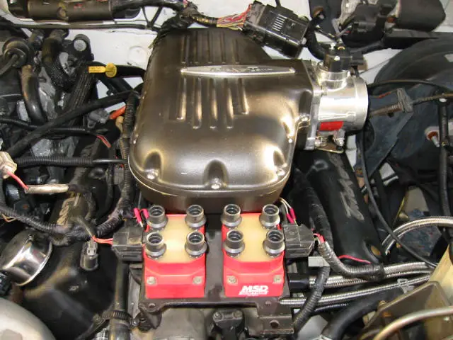

Right now we are working on dom's truck. it sleeps 8 feet from our turbo mustang and 10 feet from my brother truck. depending on when bills turbo gets here depends on whether bills truck still have a blower when Dom's truck is running. i dont know if they will ever get to try it out before it becomes a unfair race. on our list of things is to fix the fuel system, tb linkage, blow off valve, fix exhaust leak, powercoat tubes, attach fan, fix tranny cooler, break in and tune truck, and of course there will be bugs we dont know about.
We're hoping to have most things ironed out in the next 2 weeks. It does run and sounds like a dragster. It has moderate-severe exhaust leaks where the headers bolt to the heads. You can't even hear the geardriven blower!
500+ Hp to the tires is well within reach.
