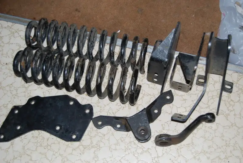

4" lift came today. still need: front shocks, 1.5" coil spacers, maybe a longer pitman arm, 3.73s. and if i can find a cheap used locker or posi ill do that, if not itll stay open. manual hubs way later down the road.
question: whats the best way to get the rubbery coating off the springs? its damaged so id want to repaint them..
Did you get ra drop brackets?which arm is that?i have ra bracket and fa 400 arm
Those square brackets look like RA mount drop brackets.
~Mark
edit: too me too long to post that one sentence.. :)
O mine look different.maybe just weird to me in the pic
Thought it was only with one company. With spaces i think your be fine
You can use a torch to burn the rubber off. Or you could have them sand blasted. When you do the lift, make sure that you do the suspension bushings, and I would do all four ball joints. You may even want to check and replace front axle universal joints.

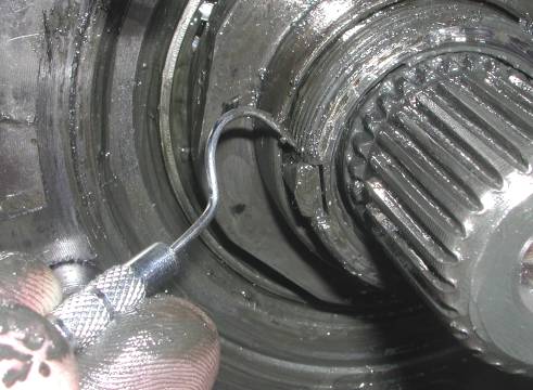

my passenger hub way be busted. the innards of the cover fall out, and i was missing the washers on the spindle end. only had the toothed gear thing, ring with teeth and the c-clip. drivers side had washers/spacers on it too.
how the hell do you get out the stubborn 'key' that holds the nut and wheel bearing on?? drivers side wont come off with a magnet or a pick. ive blasted it with brake cleaner too. passenger side came out easyyyy
this thing(glacier991's pic):
Might have to tighten or loosen it while tryn to pull it out wit a magnet
