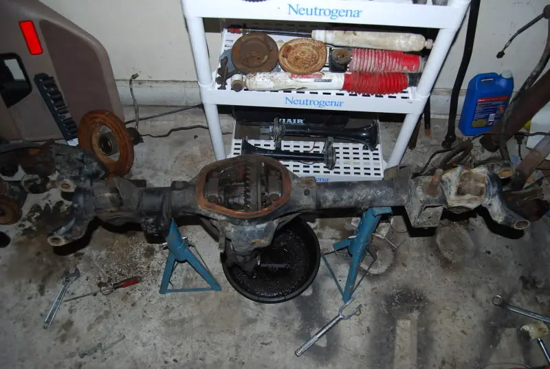

can you make something to fit the slit, sacrifice and old screwdriver, heat it and bend it, grind to fit etc? Drive a pickle fork between the knuckle to put some pressure on it? Might jamb it enough to get the nut started. Or maybe cut the damn nut off.
Great success!!
