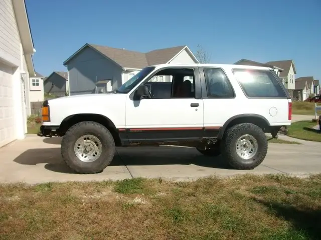

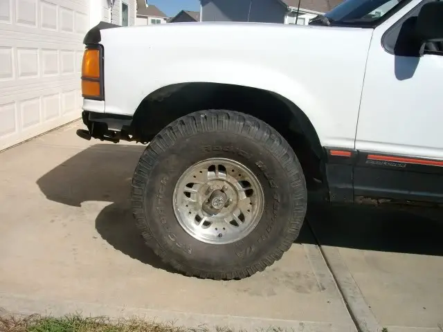

Went and got the 33's all mounted up today as well as trimmed the front fenders for a little more clearance as they were rubbing at the back of them. The rears fit without a problem and was able to max out my jack trying to get them to rub. The front tires are the old BFG MT pattern and also have a spare in the samer, the rears are Super Swamper truxus MT's. Picked all of the tires up for $100, also starting to wonder if the door sticker is actually wrong about the gearing as it still drives fine.

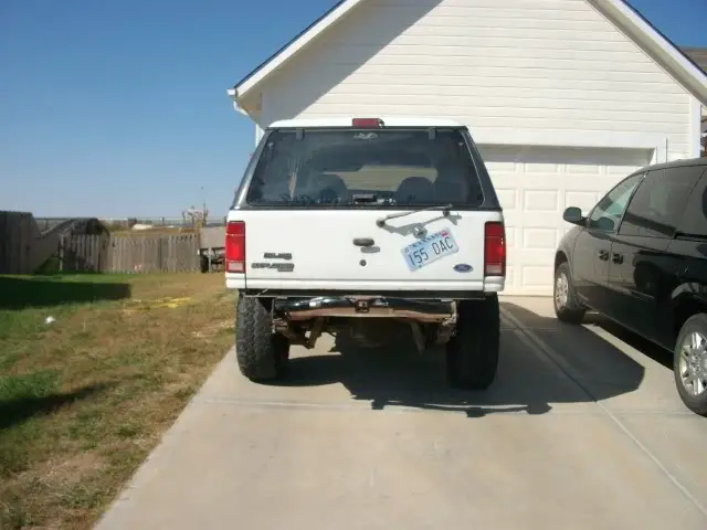

Rear hitch finished and license plate mounted
looks so big/little at the same time
fender trimming

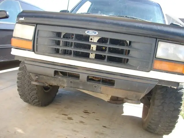

front bumper with hooks finished up

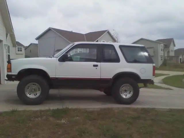

Finally recieved the leveling coils and got them installed, along with a new lower ball joint on the passenger side. Its looking like the rotor/inner bearing on the passenger side will need to be replaced.
Side note, after correcting for the difference of my odometer it looks like I'm getting 16mpg out of this thing, not too shabby for stock gears and 33's.
