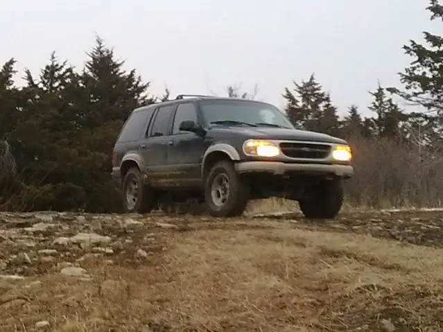

Finally making a registry for this Explorer hopefully the last new one I will make for a long time as the other two were sold. I'm calling her Billie since she's low and fat but likes to climb hills like crazy.
2000 Eddie Bauer
5.0 V8
265/70/16 Treadwright Guard Dog's
Oreilly Shackles
TT
1" body lift
4406 transfer case(currently without shift linkage)
Future Plans: (These change daily)
4.10 gears
33X10.50 BFG KM2's when the treadwrights wear out in a few years
tube bumpers
sliders
lockers front and rear
Who knows when these things will actually get done it sucks being a broke college student.

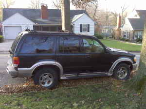

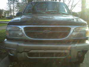

stock as I saw it in the for sale ad on craigslist

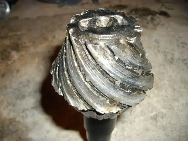

When I bought it I knew there was something wrong with the front axle, so after tracking one down for $100 swapped it in and this is what was inside the old axle.
A completely trashed pinion

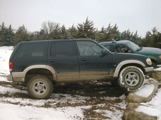

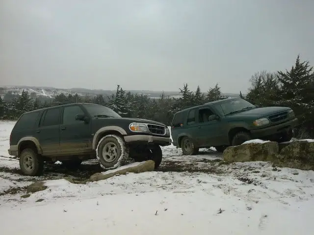

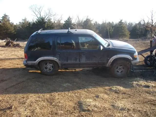

more pictures
The frost bite Explorerforum attendee's

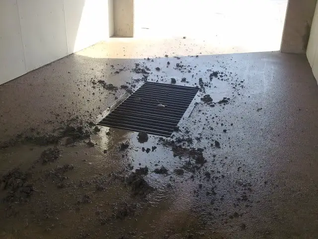

And the mess she made at the car wash

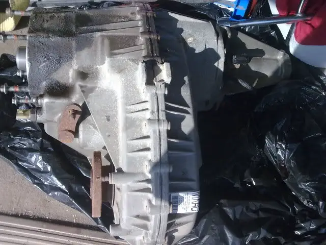

Got a line on a 4406, hopefully going to pick it up this weekend. To bad there's no shifter with it but good thing it has less than 50,000 miles on it.

Get to go pick up my 4406 for $150 tomorrow.:party: can't wait to get that in its going to be awesome with 2wd and 4low.

Mainly just because I like pictures figured I would add these then, now to just get all of the parts that go with it.
Parts still needed:
Rear Driveshaft(5.4 Expedition 4x4)
Front Driveshaft (4.6 F150/Expedition)
Shifter linkage
Hopefully I make enough money over spring break to at least get a rear driveshaft then can put it in and have 2wd and hopefully some better mpg on the highway. Just need to make sure I have 4wd in time for SMORR.

120 lbs big. I think the awd case is 75 lbs.
The shifter is the hard part to find. Focus on that.
It might be good to call around and let them know you want one so they don't torch em getting the transmissions out. I told a yard in Wichita I would give them 100 for one and he called back a few days later. Once they know it has value they may work around it for you.
Oh goody a volunteer to help lift the case in:p:.
I actually saw an F150 at picknpull but someone beat me to all the shifter linkage, and the Expedition had a 4.6 it so guess I could have got my front shaft but stupid me got a parking ticket earlier in the day so that will get taken care of first. It will still be a few weeks before I can buy anymore stuff so then I can look around more. The good thing about being close to KC means alot of junk yards.
