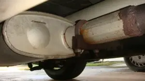

Ok, I'm ordering the dynomax super turbo right now, have read all the exhaust threads and everything, but there is one thing that is still confusing. I've read that the stock exhaust is 2.25 in/out, and I've read confusing things about getting either the 2.25 in/out or the 2.5 in/out. What I'm looking to do at least in the beginning is just simply replace the stock muffler with the dynomax, keeping the resonator and everything else, until I decide to get rid of it. So to me it would make sense to go with the 2.25 one, but every single website says only the 2.5 one will fit the sport tracs. So is it not a problem for shops to make the 2.5 inch muffler fit, or are they going to say I got the wrong size? Just want to make sure before I buy this thing. Thanks in advance
EDIT: basically a decision between the 17731 and the 17733
