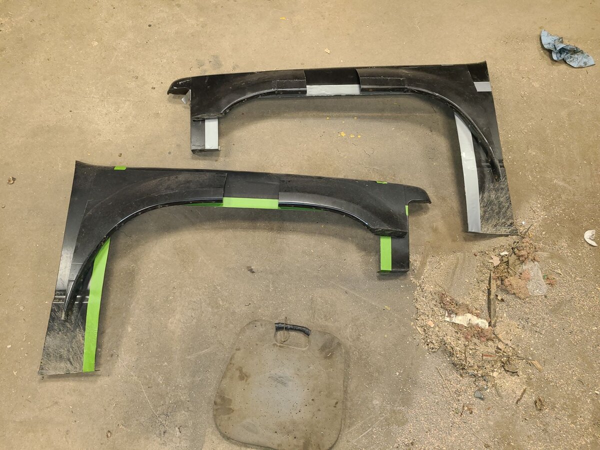

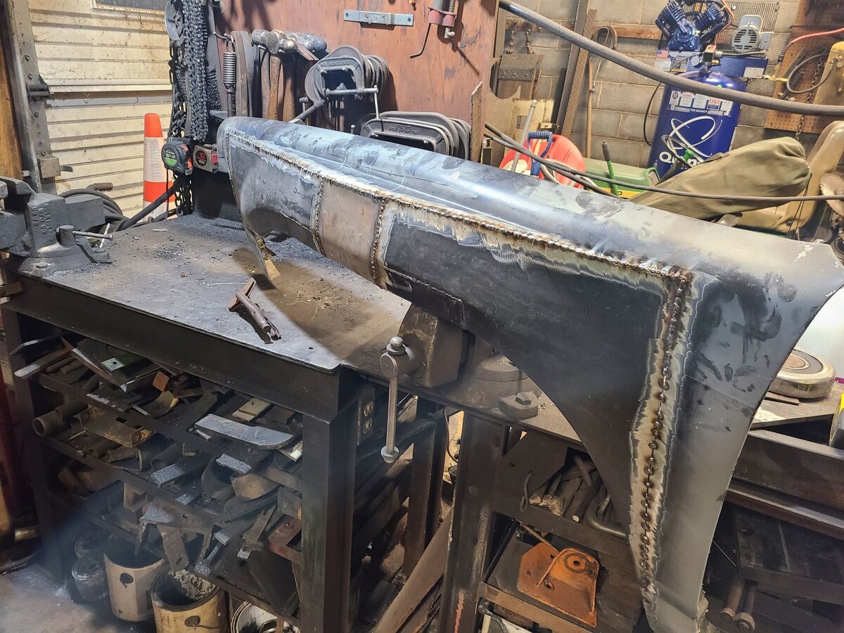

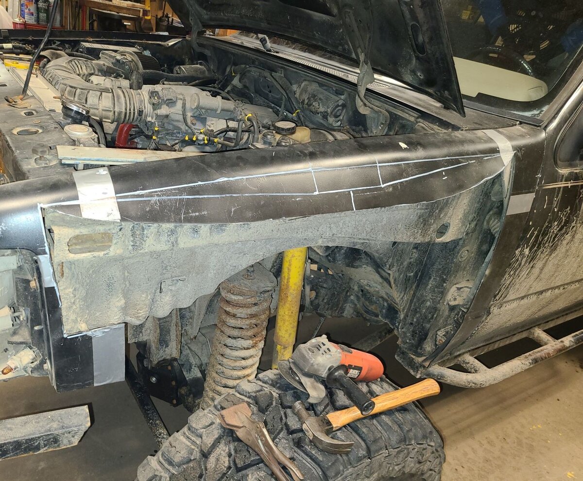

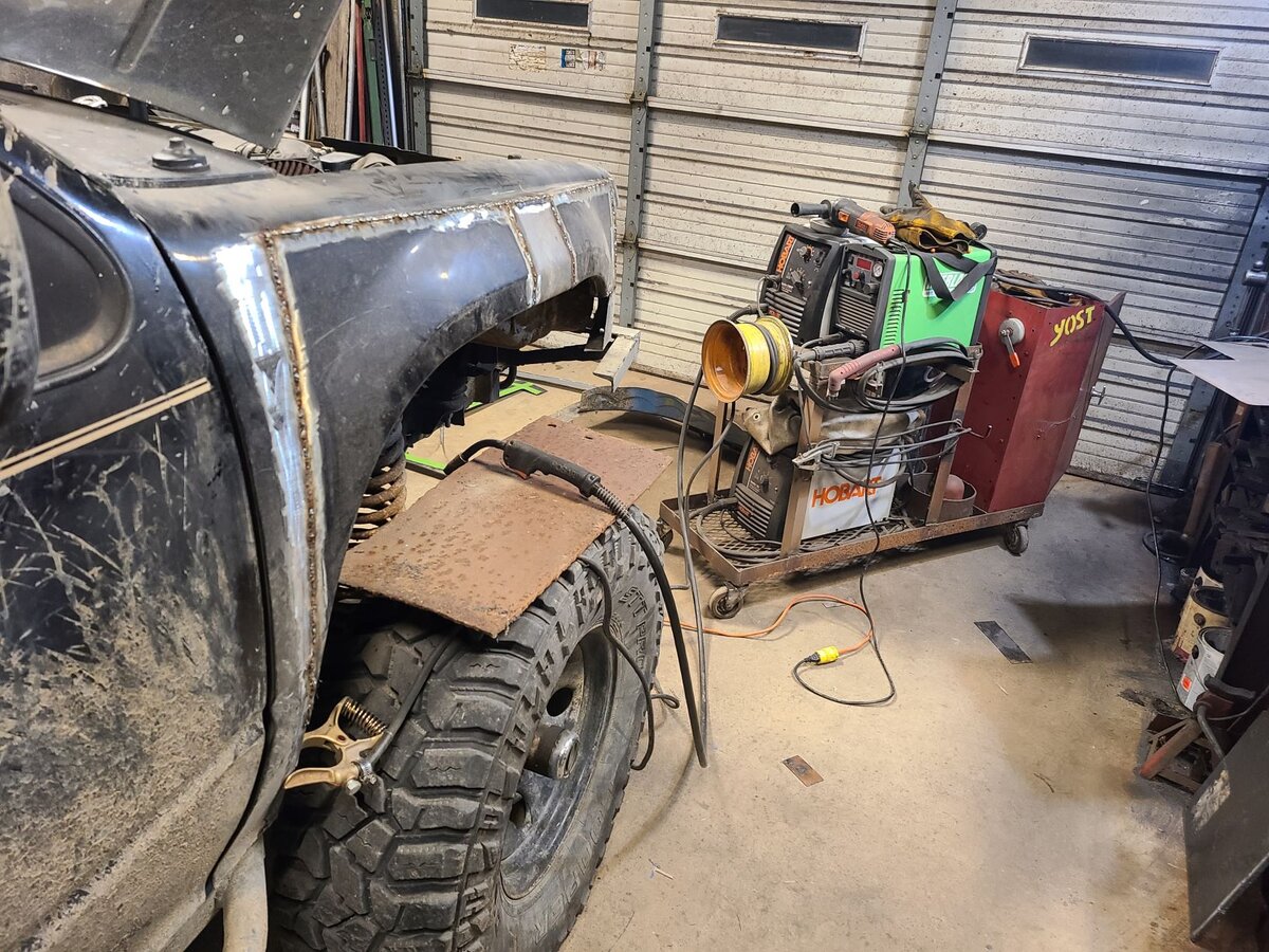

I got tired of the kiddie pool fender flares so it was time for a change.

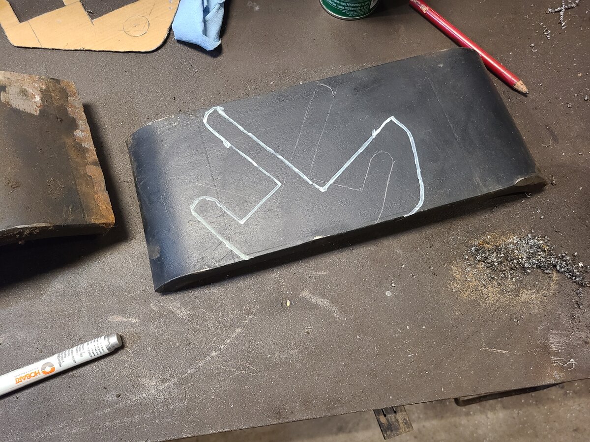

Cut and fold
Welding it up
Test fitting
Waiting for paint.
I still will have to run a flare of some sort. I upgraded from kiddie pool to garden edging flares.

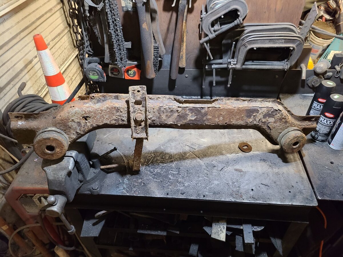

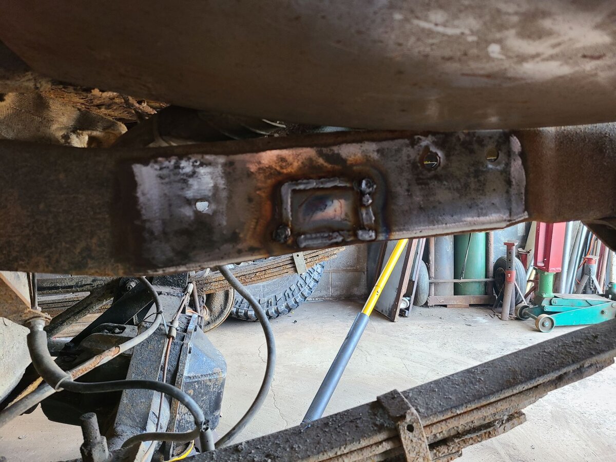

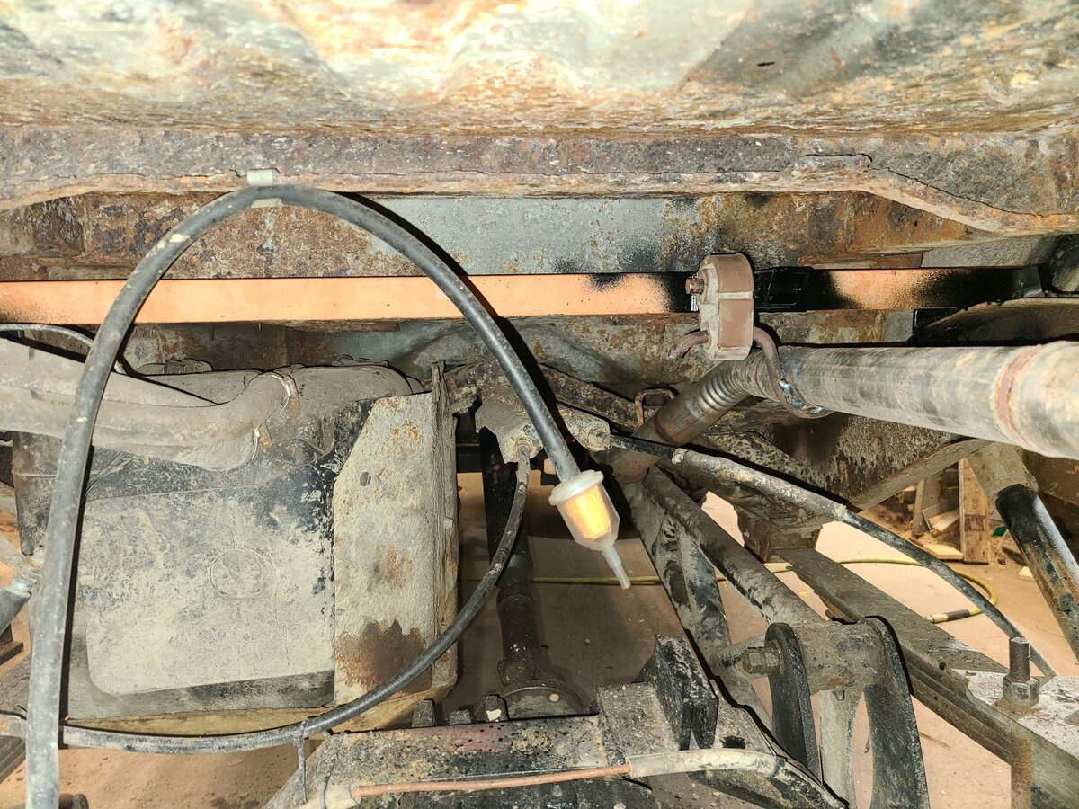

This crossmember was rotted out. Decided to build a new one to replace it and tie in the cage.
New crossmember installed and made a new hanger mount for exhaust. The hanger is way better than what I had on there before.

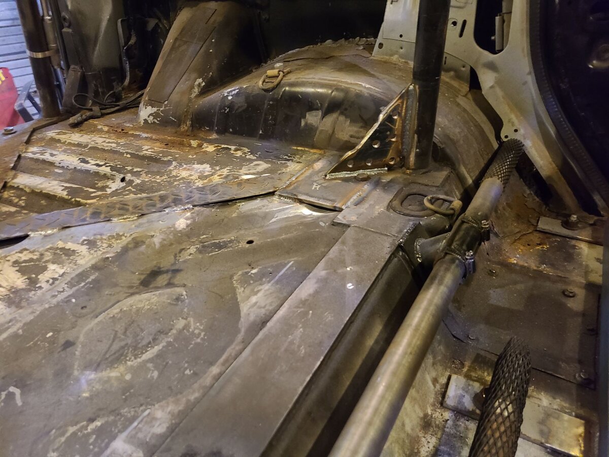

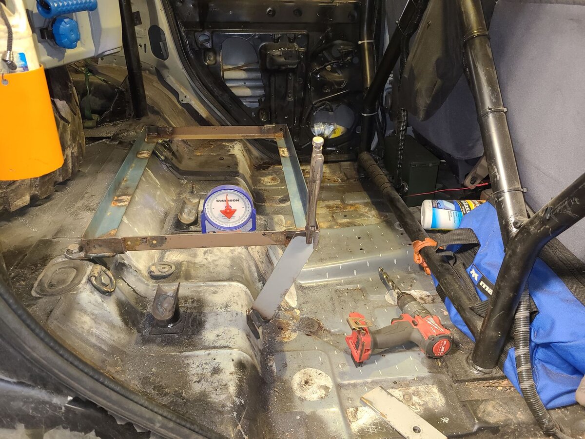

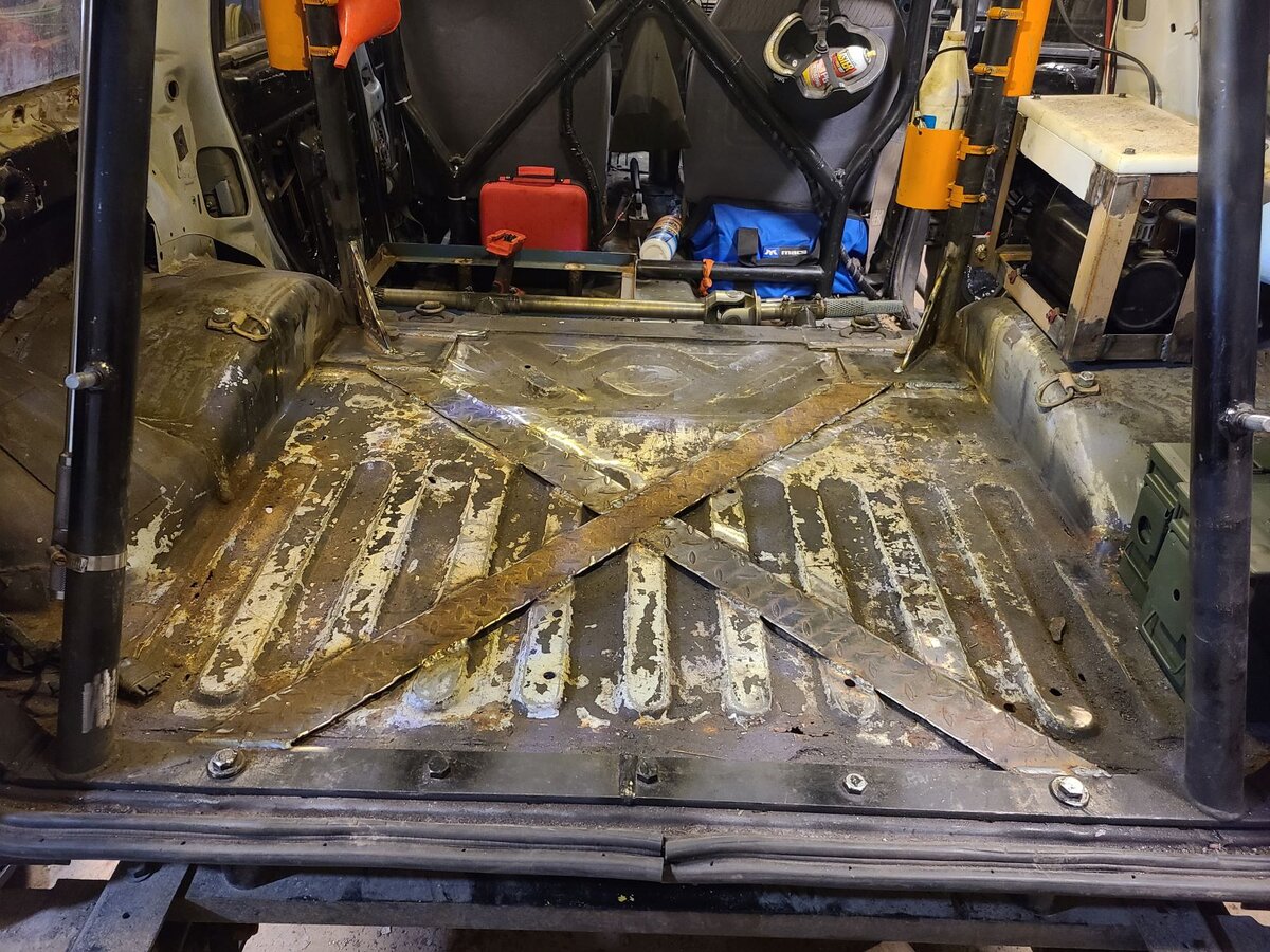

Floor was rotted and sagged down due to hauling the 37" spare all the time.
I reinforced it and tied it into the cage.
The bolt at the triangle gusset is my new body mount location.

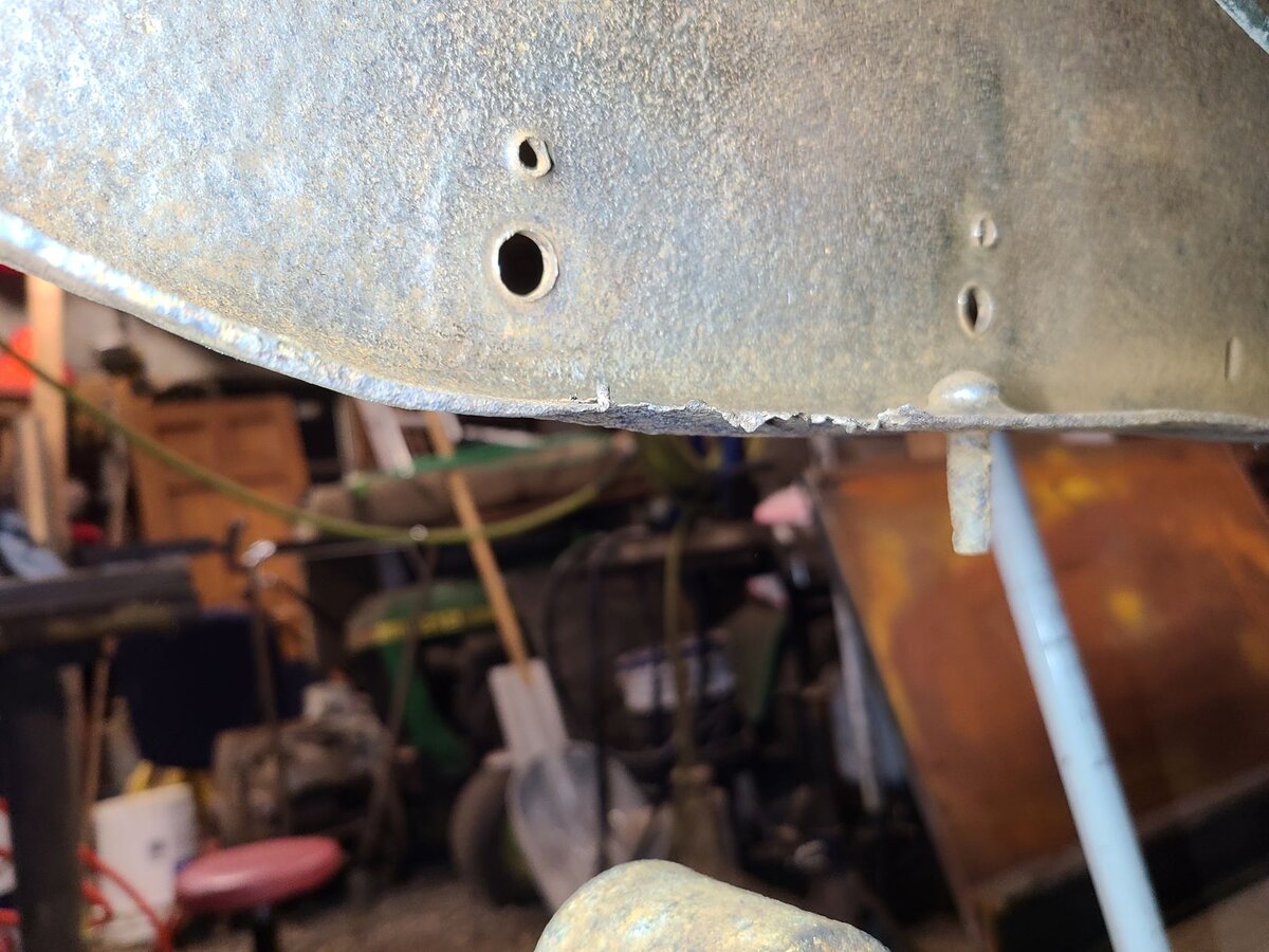

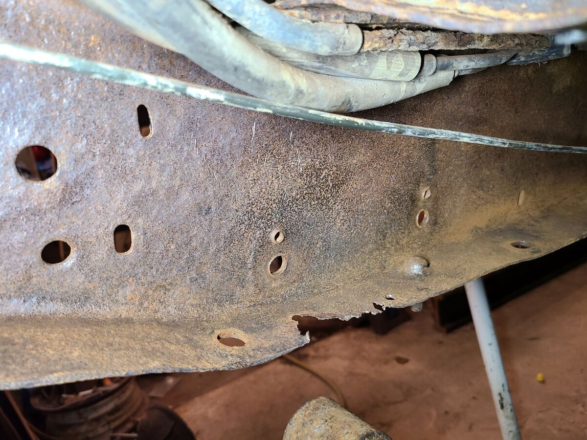

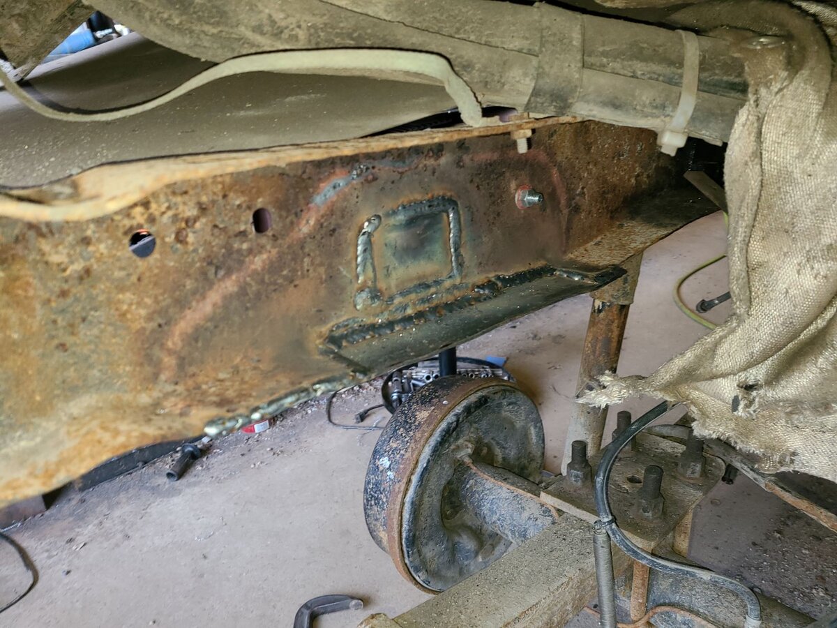

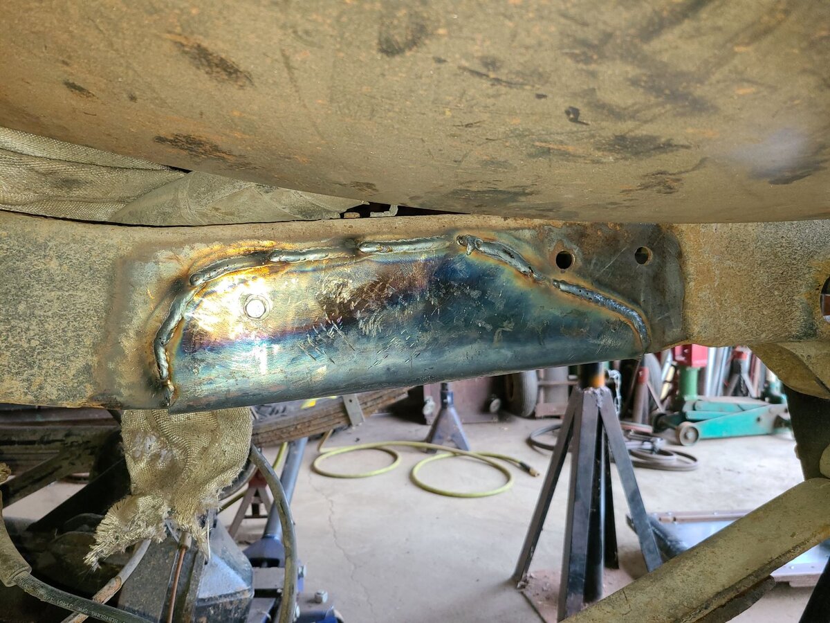

Hole in the frame. Cut out and patched. I then plated the frame.
Welded on the inside.
Plate on outside of frame.

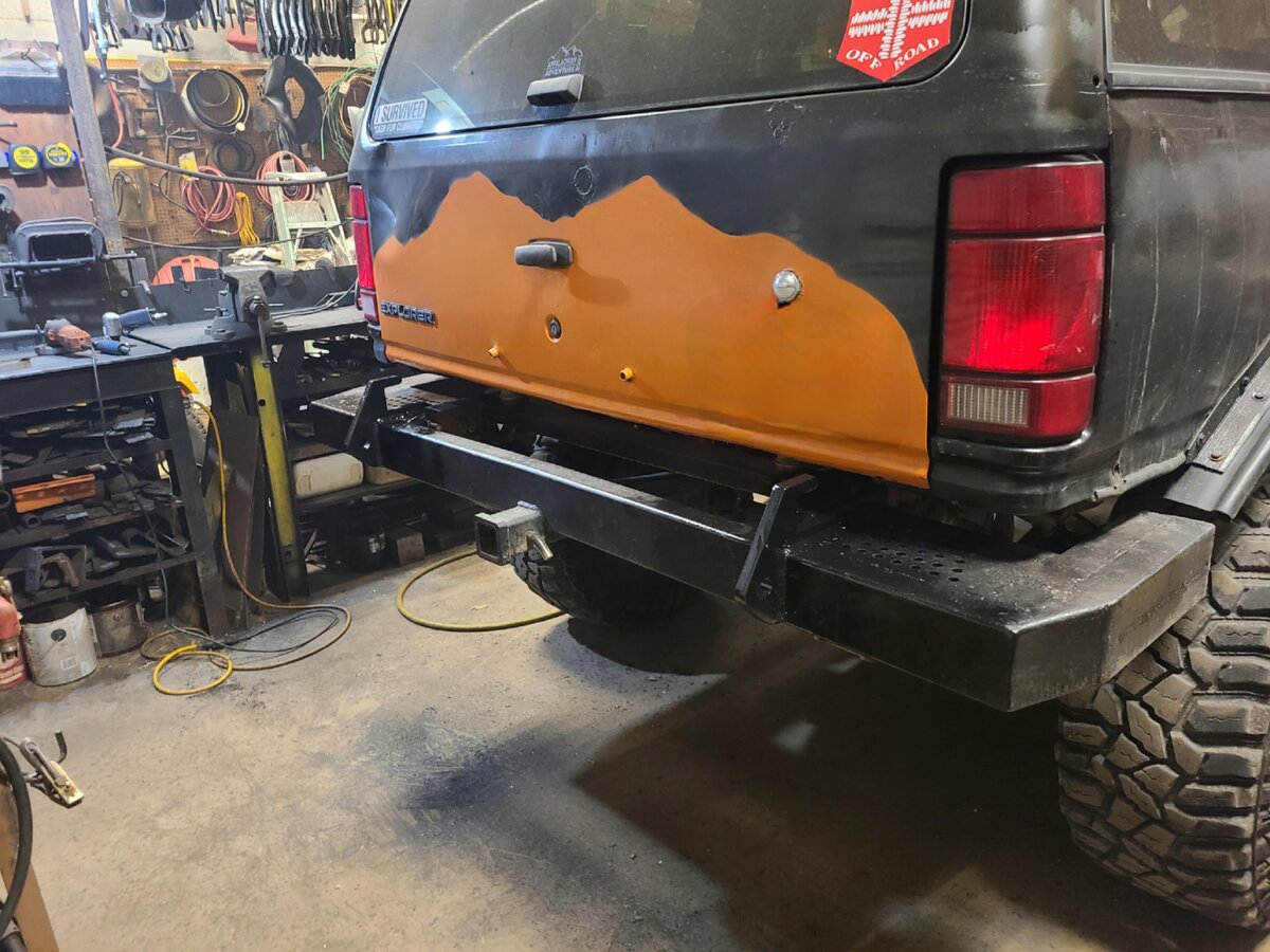

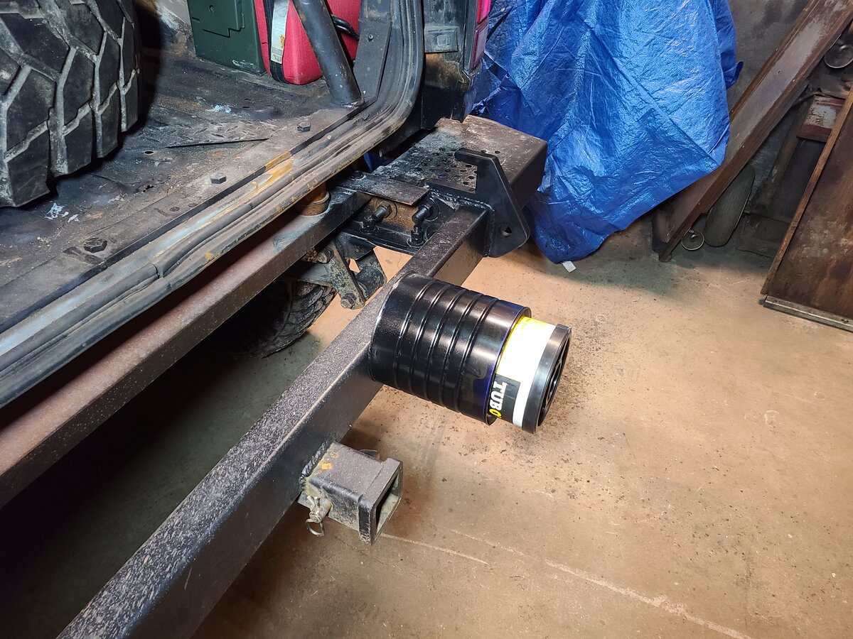

Rear crossmember that I replaced a while ago. I tied that crossmember into the leaf spring shackle mount.

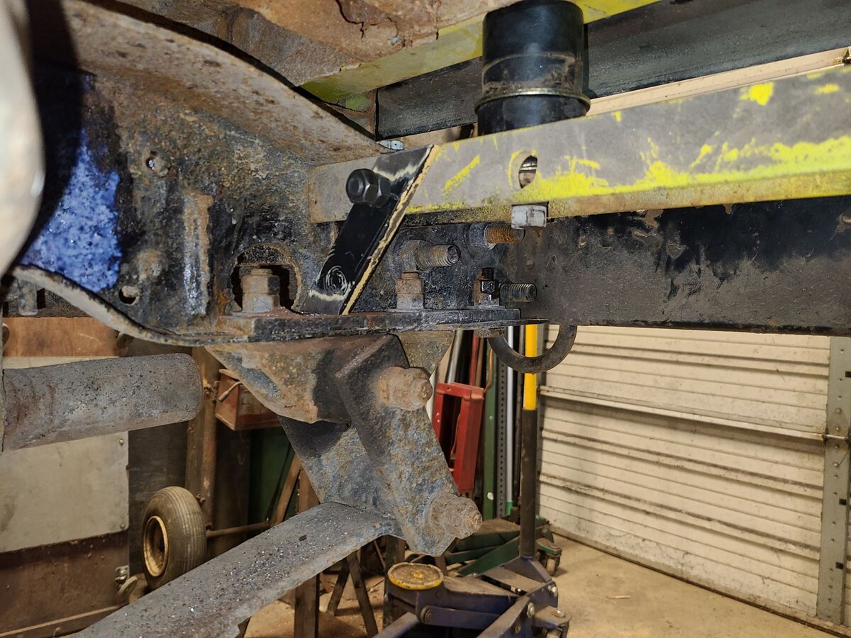

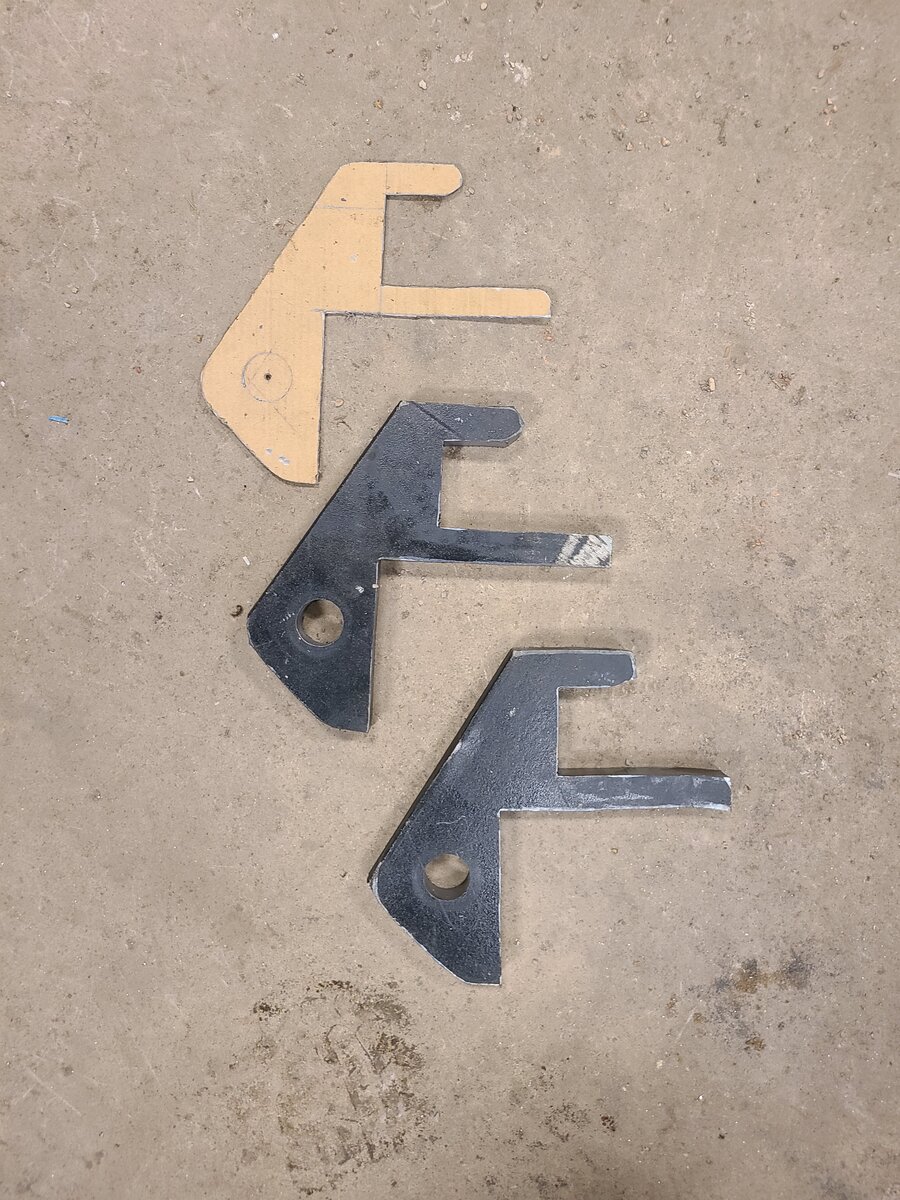

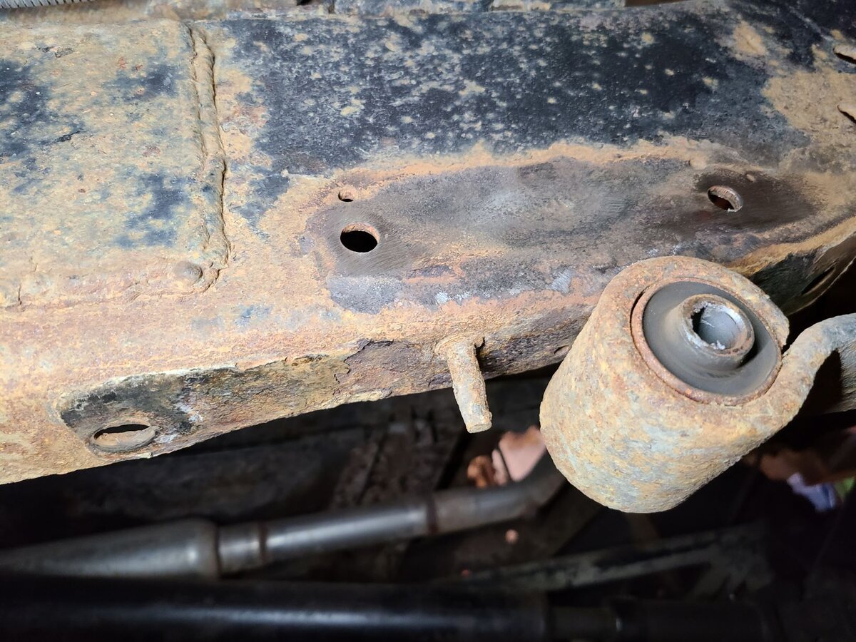

Here is my front leaf spring mount.

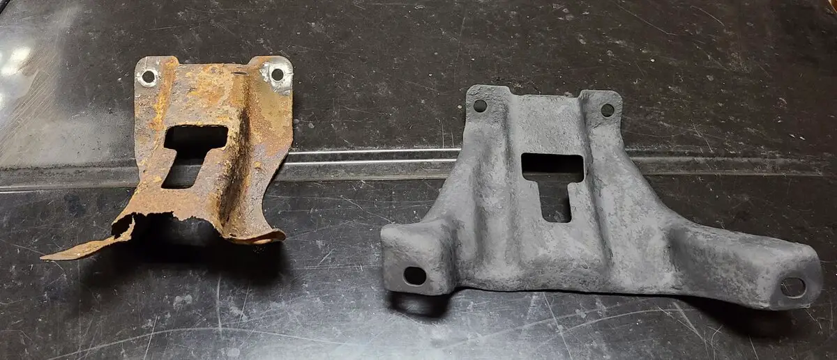

I parted out a 1996 explorer to get frame parts for mine.

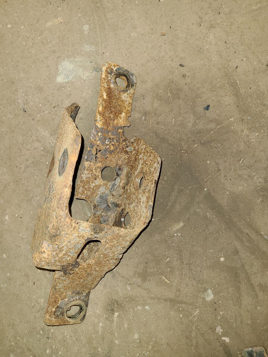

On the left is a crossmember bracket that holds the gas tank strap. The 1996 bracket on the right. It was like they figured out that the older style holds debris in until rotting occurs and then upgraded the design. Way better.

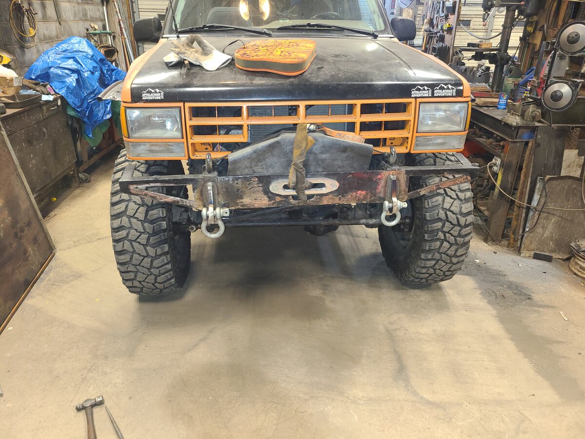

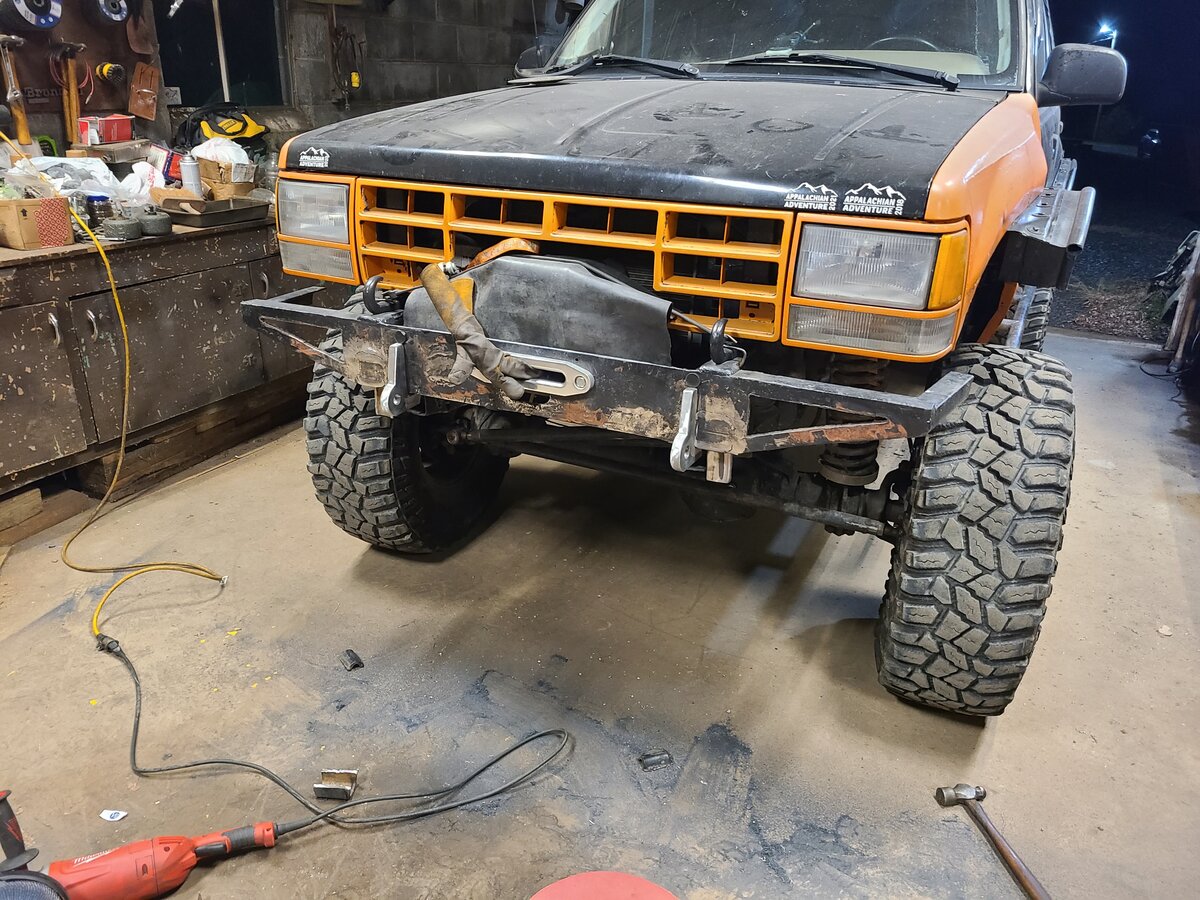

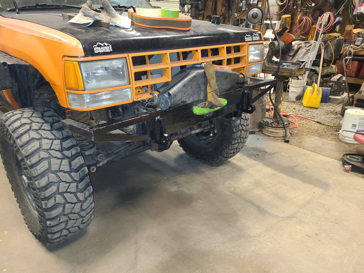

  • better recovery points (done and pictures in the previous post)
  • Swap leaf springs and weld on new perches. (I need to use the tape measure this time)
