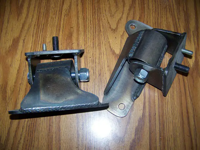

Auto Fab Motor Mounts
I purchased some autofab motor mounts. I am building my own for the transmission identical to the autofab trans mount. I can't wait to get them in and get rid of the drivetrain slop.

I got the auto fab motor mounts installed... Wow what a difference they make. It is a joy to drive again and doesn't sound like it is going to fall apart!

The motor mounts were $240 + shipping. They are pricey but money well spent imo. Here is the link to them.
